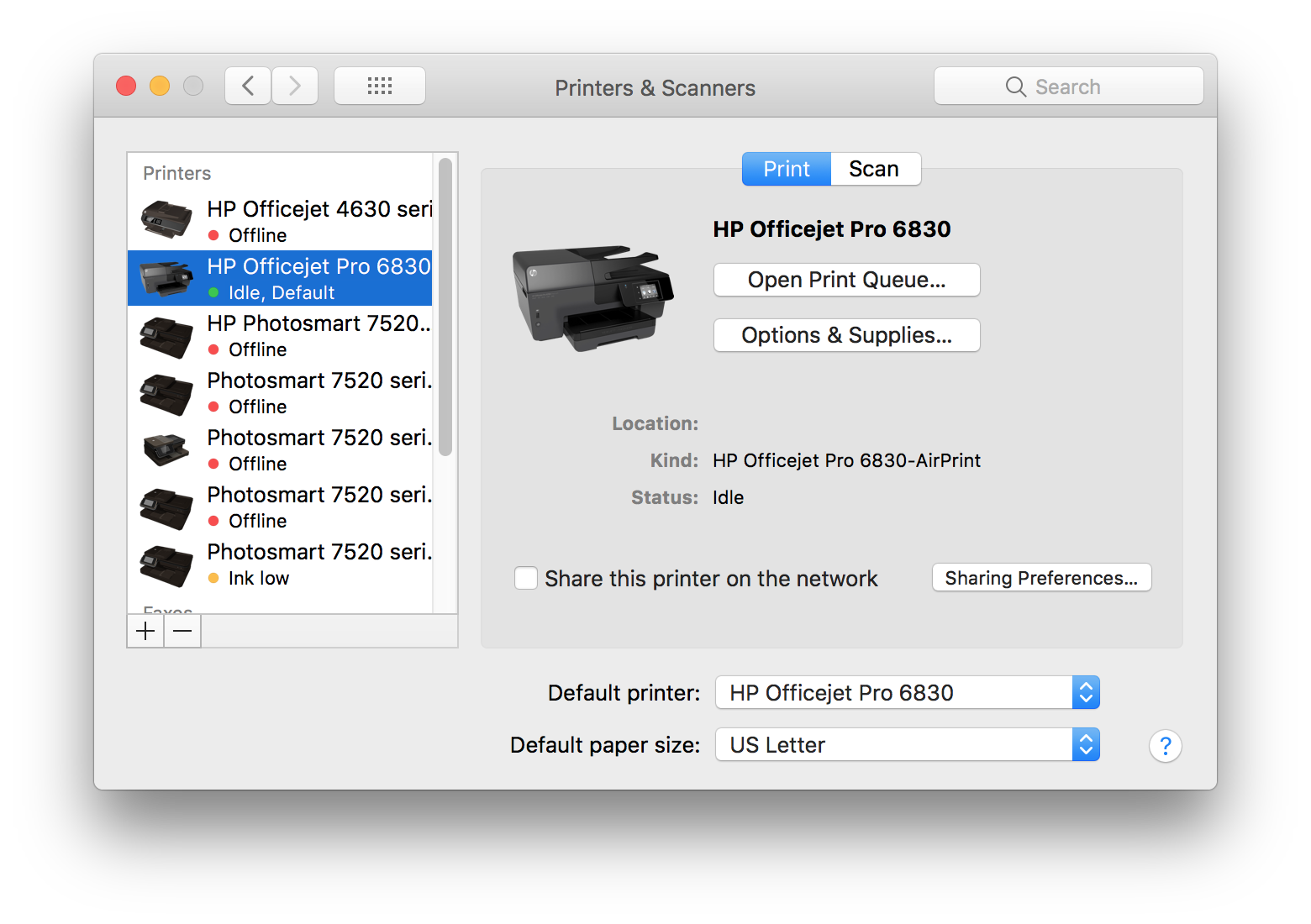

Set the preferred paper size for all your documents
The Printers and Scanners portion of the Mac’s System Preferences enables you to set the paper size for all your documents.
1. Choose the menu command: Apple > System Preferences….
2. Click Printers & Scanners in the second row.
3. At the bottom, choose the format you want from the Default paper size pop-up menu.
☞ The Operating System offers US Letter, US Legal, A4, A5, JIS B5, B5, Envelope #10, Envelope DL, A3, Tabloid Oversize, ROC 16K, Envelope Choukei 3, and Super B/A3. Be aware that your printer may not have these available, even if you can choose them in here.

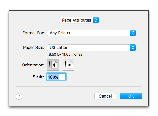

Determine the orientation of the printed page
1. Choose the menu File > Page Setup….
► Click portrait for standard letter formatting.
Figure 151
Portrait orientation
► Click landscape for greater width than height.
Figure 152
Landscape orientation
2. Click OK.

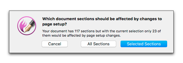

If your document has multiple sections and you choose Page Setup… a sheet appears illustrated in Figure 153 asking for which section(s) you want to have the settings in Page Setup apply.
Figure 153
The Multiple Sections Page Setup sheet
The available choices are:
• Selected Sections
This refers to as many or few sections in which your insertion point appears.
• All Sections
This refers to all the sections of your document whether or not your insertion point appears there.
• Cancel
This gives you a chance to return to your document and reflect on your options.

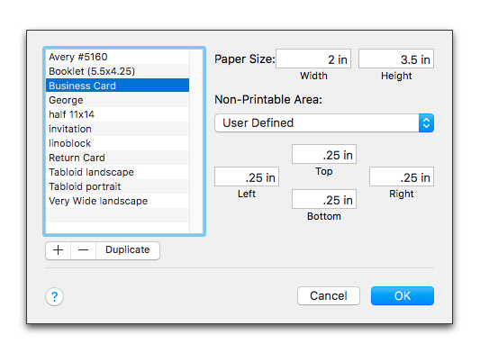

Use a custom paper size
Most paper in the United States comes in either legal or letter size. However you may want to produce a book or some other item with a custom paper size.
1. Choose the menu command: File > Page Setup….
2. Choose Manage Custom Sizes from the bottom of the Paper Size pop-up menu.
3. Follow the interface in the dialog and enter the values you want.
4. Click OK.
Figure 154
The Custom Paper Size dialog of the Page Setup dialog
Your custom paper size then appears at the bottom of the Paper Size pop-up menu.

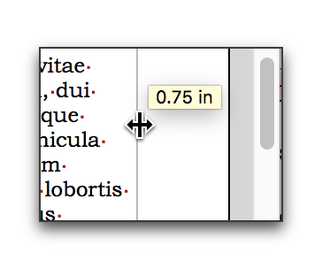

Set the margins visually
Changing the margins of your document is as easy as dragging the line that appears around the printed area to the location you want.
1. Choose the menu command: View > Page View (if your document is not already displayed as a page).
Paper size, margins and line wrap areas are meaningless in Draft View and Full Screen view.
2. Choose the menu command: View > Page Guides > Show Page Guides (if you do not already have the page guides displayed).
☞ To prevent accidentally changing the margins by dragging the page guides choose the menu command: View > Page Guides > Lock Page Guides.
You can change the margins with the Page Guides turned off, but having them on is much easier.
You can print these guides as explained in “Print page guides & “invisibles”” on page 558.
3. Place your pointer over the Page Guide representing the margin you wish to move.
Your pointer changes to a “margin mover” as illustrated in “Mouse cursors” on page 12.
4. Click and drag your pointer (and the Page Guide with it) so that the margin is where you want it.
A “help tag” appears to let you know where your margin is in relation to the edge of the paper.
Figure 155
Setting the margins visually

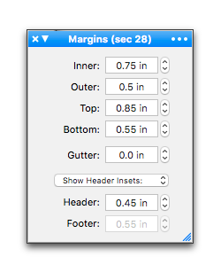

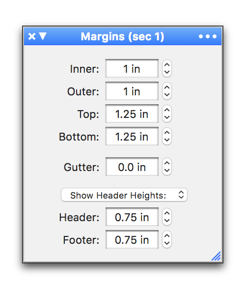

Set the margins numerically

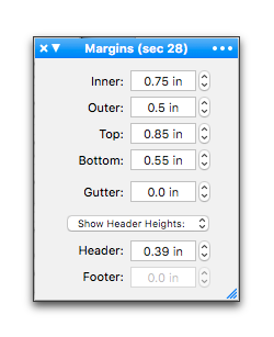

You can change the location of the margins by typing the precise locations you want in the Margins palette of Nisus Writer Pro. Because you make these changes numerically and not visually, you do not need to have your document displayed in Page View to proceed so you can see the result.
1. Open the Palette Dock and select the Sections palette group from the icons at the top, or, choose the menu command: Window > Palettes > Floating Palettes > Margins.
Figure 156
The Margins
palette showing the margins for the shipped Nisus New File
◦ The terms Inner and Outer refer to the edge of the paper closest to the binding and to the outer edge (if there would be a binding).
◦ The terms Top and Bottom refer to the margins of the body of the document, that is the distance from the actual top or bottom of the page, independent of the header or footer (if they should appear).
◦ The terms Header and Footer refer to the outermost edge at the top and bottom of your page that your printer will support.
Choose Show Header Heights and think of the footer as starting at the bottom of the main body text area, and the “height” expanding downward from there. For the header, and this is somewhat counterintuitive, the header starts at the top of the main body area, and expands upwards from there. Put another way, the bottom of the header is its start point as far as measuring its extent (height) goes.
Choose Show Header Insets and the same thing happens: the bottom of the header is locked to the top of the main body area, and the top of the footer is locked to the bottom of the main body area. It's merely the opposing edge whose inset you are choosing (e.g.: you control the inset for the top edge of the header).
As an example, illustrated in Figure 157 below, this document has a header height of 0.39 inches and a footer height of 0.0 inches (footers are hidden). However, its header inset is 0.45 inches and footer inset is 0.55 inches.
Figure 157
The Margins palette showing the header and footer heights and insets for the current section of this document

2. Double-click your insertion point inside whichever field you want to change and enter the value required.
3. Press ⇥ to continue to the next field or ⇧ ⇥ to reach the preceding field.
☞ This sets the margins of all selected sections to the actual figures entered in the various fields.

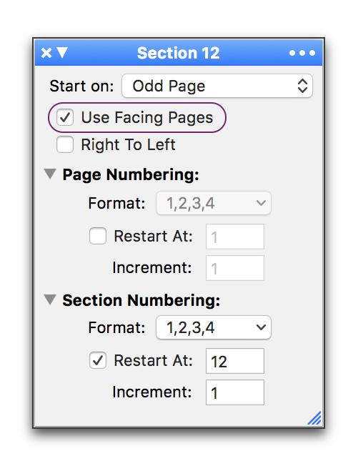

Mirror page placement
You may want to print your document for binding so that the text appears on both sides of a piece of paper. In that case you would probably want your margins to “mirror” or “reflect” depending on whether they are on the odd or even page.
1. Open the Palette Dock and select the Sections palette group from the icons at the top, or, choose the menu Window > Palettes > Floating Palettes > Section as explained in “Set the margins numerically” on 172.
2. Click Use Facing Pages.
Figure 158
The Section palette showing Page, and Section Numbering options
