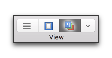

Figure 229
The Page View button on the Toolbar selected

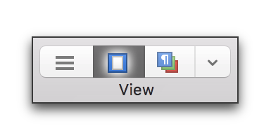

Page View
As explained in the section on Pagination beginning on page 288, Nisus Writer Express comes preset for your new files to display ready to print your file on paper.
To display your document as it would appear on paper:
► Choose the menu command: View > Page View.
► Click the Page View button on the far left of the Nisus Writer Express Toolbar.

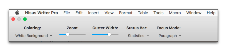

Figure 230
The Menu Bar and options available while in Full Screen view
Moving your pointer to the top of the screen reveals the Menu Bar and a number of Full Screen view options. While you can set a number of these in the Appearance preferences and elsewhere, what you choose here will override those choices. These possibilities include:
• Coloring
A pop-up menu offers:
◦ White Background
shows your text on a white background while also showing any color attributes you have added to your text such as
Highlight, Text Color and/or Background Color.
◦ Dark Background
shows your text as white on a black background while also showing any color attributes you have added to your text such as
◦ Green Phosphor
shows your text as green on a black background while also showing any color attributes you have added to your text such as
◦ Show Preferences
Opens the Appearance preferences of Nisus Writer Express where, in the
Colors portion, at the bottom of the window you can set your preferences for the Document Views controlling Full screen background, Full screen caret, Full screen gutter, and Full screen text.
• Zoom
◦ A slider where you can change the Zoom percentage of the text in the main text of your document window.
• Gutter Width
◦ A slider where you can change the size of the gutter relative to the main text of your document window.
• Status Bar
◦ None
hides the entire Status Bar.
◦ Statistics
Displays only the statistics you have chosen to display in the Status Bar
◦ Full Bar
Displays the full Status Bar
• Focus Mode
A pop-up menu allows you to quickly switch the focus mode, so inactive text appears dimmed. For more details see the section on
focus mode.

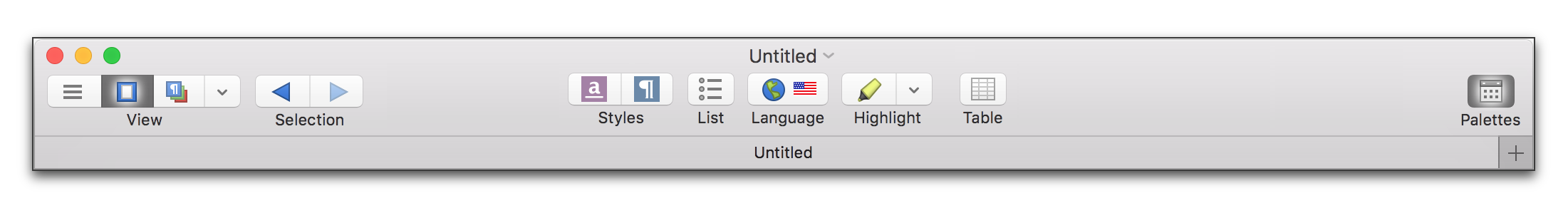

You can display all your documents in tabs of one window that are familiar from Web browsers).
Nisus Writer Express displays a Tab Bar between the Toolbar and the Horizontal Ruler (if they are visible). At the far right of the Tab Bar a Plus + sign enables you to open a new untitled document as a new tab. If multiple tabs are open, a close button appears at the left edge of each tab when your pointer hovers over that spot. The document’s name appears in the center of the tab. Whichever tab is active determines the name of the file in the title bar of the window.
Display your documents as tabs in existing windows
You can start displaying your documents as tabs in one window in a variety of ways.
Tabbed window behaviors are partially determined by macOS. This makes their behavior hard to predict precisely in Nisus Writer Express. That said, the menu command: Window > Document Tabs > Automatic only adds documents as a new tab if a tabbed window already exists, while the menu command: Window > Document Tabs > Always will (naturally) always add a document as a tab, and the menu command: Window > Document Tabs > Never, well…, I’ll never say never, never again.
Use tabs to display your documents in one window
► In a new untitled, or existing open document, choose the menu command: View > Document Tabs > Show Tab Bar. If it is a new document it will appear as illustrated in Figure 232. If it is an existing document, or, when you save the document its name appears in the title bar of the window and in the tab as illustrated in Figure 233.
Every time you choose the menu command: File > New (or click the Plus + sign or choose the menu command: View > Document Tabs > New Tab) the Untitled document (based on the Nisus New File) will appear with its Tab Bar displayed and be added to the window of any existing document as illustrated in Figure 234.
► Choose the menu command: View > Document Tabs > New Tab.
If you do not have the Tab Bar turned on and you do not use tabbed windows on a normal basis the menu command: New Tab will add a tab to the active window. This does not affect the command File > New, which will continue to open new Untitled documents in new windows.
► Choose the menu command: View > Document Tabs > Use Tabs > Always.
This automatically turns on the menu command: View > Document Tabs > Show Tab Bar. Every time you choose the menu command: File > New (or click the Plus + sign or choose the menu command: View > Document Tabs > New Tab) the Untitled document will appear with its Tab Bar displayed and be added to the window of any existing document.

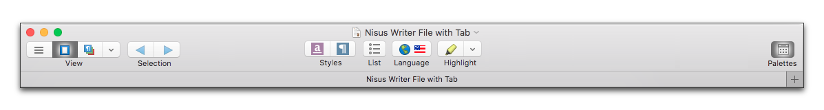

Figure 232
An untitled Nisus Writer Express window with the Tab Bar turned on
An untitled Nisus Writer Pro window with the Tab Bar turned on and the document saved with a name (2).png
Figure 233
An untitled Nisus Writer Express window with the Tab Bar turned on and the document saved with a name

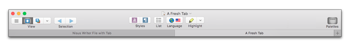

A Nisus Writer Pro window with the Tab Bar turned on and a new tab added (and saved with a name).png
Figure 234
A Nisus Writer Express window with the Tab Bar turned on and a new tab added (and saved with a name)

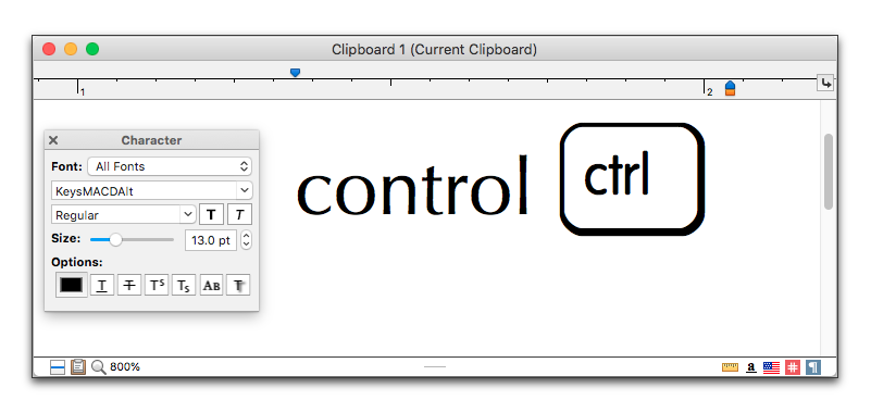

Figure 235
The Clipboard zoomed to 800% to examine an unusual 13 pt character

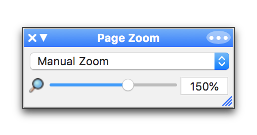

Use the Page Zoom palette
While it does not appear in any of the default sets, the Page Zoom palette is very useful. As with the Status Bar at the bottom of each Nisus Writer Express document window, its title bar indicates (when in Page View) the page number of the currently displayed page (not the location of the insertion point), and the total number of pages in your document. A “magnifying glass” and slider indicate the percentage to which you have zoomed your window and enables quick zooming. It also offers additional tools relating to the magnification of your document’s display.
Show the Page Zoom palette
► Choose the menu command: Window > Palettes > Floating Palettes > Page Zoom or View > Palettes > Floating Palettes > Page Zoom.
Figure 236
The Page Zoom palette
Magnify, or, zoom in and out
► Click and drag the slider in the Page Zoom palette.
► Double-click in the percent zoom text box and type the percent you want to increase or decrease the display.
You can have a different zoom percentage for Page View or Draft View. The percent set in Draft View is maintained in Full Screen view.
When in Page View Nisus Writer Express can zoom your page in a variety of manners.
Show the maximum width within the Page View window
► In the Page View palette choose Show Text Width from the pop-up menu at the top.
This zooms your document in such a way so that the entire text width of your page is always visible while hiding the margins. As you resize the window, the page zooms.
Show the maximum width including the margins in Page View
► In the Page View palette choose Show Page Width from the pop-up menu at the top.
This zooms your document in such a way so that the entire page of your document is always visible including to the edge of the page (on which it might be printed). As you resize the window, the page zooms.
Show the entire width and height in Page View
► In the Page View palette choose Show Entire Page from the pop-up menu at the top.
This displays your document in a format similar to Page (or Print) Preview; it is, however, fully editable. In this view you can scroll through your document one full page at a time by clicking your pointer on the scrollbar. As you resize the window, the page zooms so that an entire page is always visible.
Show the text zoomed at a designated percentage in Page View
► In the Page View palette choose Manual Zoom from the pop-up menu at the top.
This displays your document at whatever zoomed percentage you set. As you resize the window, the page zoom remains the same and portions of your document’s text may be hidden.
In addition to the tools of the Statusbar’s Page Zoom tag the Page Zoom palette contains the tools of the Page Number tag.
If you have multiple sections in your document or you have begun your page number counting at something other than 1, you can choose commands from the “…” (Ellipsis, or Options menu) to Show Physical Page Numbers (that is, counting every page that would print on paper) or Show Logical Page Numbers (that is the numbers of pages you have assigned in Nisus Writer Express).
You can also choose the menu command: Go to Page…. You can learn more about quickly moving between distant pages of your document in the section: “Jump to a particular page” on page 259.
Focus on Your Writing
With the deluge of digital data flooding into our workspace it is good to have tools that can help us focus. In addition to Full Screen view described beginning on page 249, which minimizes distractions from other applications that might be running, Nisus Writer Express can help you dim inactive text.
When focus mode is enabled only the text containing your selection or insertion point appears brightly. All inactive text fades out and appears dim on screen. To control focus mode use the commands on the menu View > Focus Mode:
• None: Disable focus mode and display all text normally.
• Line: Focus the line containing your selection or insertion point.
• Paragraph: Focus the entire paragraph containing your selection or insertion point.
You can set the degree to which Nisus Writer Express dims inactive text by the option “Focus mode fades inactive text by” in the Appearance Preferences.
☞ Focus mode is purely an on-screen display feature. It never affects printouts or PDFs.
Focus can be particularly useful when you are examining your document and using Find/Replace to search for a particular instance of a find expression. If you set your focus mode to Line, not only will the selection highlight (as set in the Appearance preferences of Nisus Writer Express, explained in the section: “Find & replace” on page 360) and make the found item stand out, with all other text, above and below the selection dimmed your eyes are sure to focus on what you seek.
