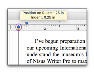

► Drag the First Line In/Outdent maker across the ruler and release the mouse button or trackpad at the position where you want the first character of your paragraph to appear.

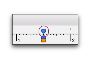

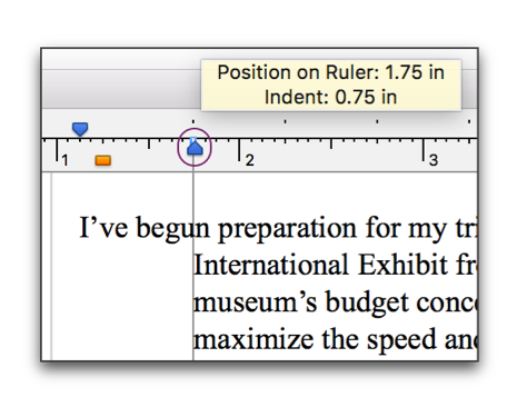

Create a hanging indent
Examine the highlighted area at the bottom of Figure 88 below.
► Drag the Left Indent marker across the ruler and release the mouse button or trackpad at the position where you want the text to wrap.
► For right to left text, do the reverse: drag the Right Indent marker.

Figure 88
The First Line In/Outdent marker relative to the Tail Line Wrap Indicator (outdent or
hanging indent)

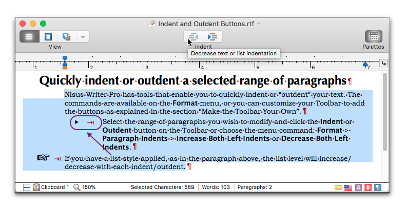

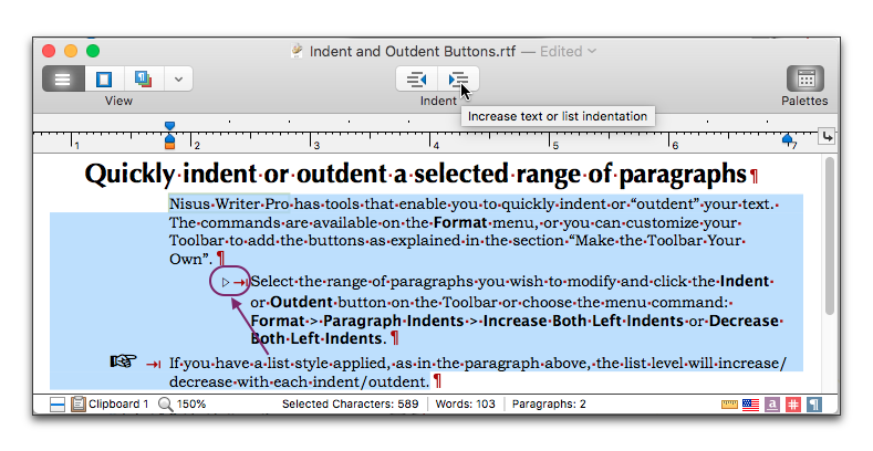

Quickly indent or outdent a selected range of paragraphs
Nisus Writer Express has tools that enable you to quickly indent or “outdent” your text. The commands are available on the Format menu, or you can customize your Toolbar to add the buttons illustrated in Figure 38, as explained in the section “Make the Toolbar Your Own” on page 393.
► Select the range of paragraphs you wish to modify and click the Indent or Outdent button on the Toolbar or choose the menu command: Format > Paragraph Indents > Increase Both Left Indents or Decrease Both Left Indents.
Figure 89
A range of paragraphs with the
indents set at the left edge of their designated styles
Figure 90
A range of paragraphs after clicking the Indent button
☞ The Indent and Outdent buttons are available if you customize your Toolbar, as explained in the section “Make the Toolbar Your Own” on page 393.
☞ If you have a list style applied, the list level will increase/decrease with each indent/outdent.
☞ Note that the Outdent button in Figure 89 is dimmed (disabled) as the left-most character is already as far left as it can be for its applied style.

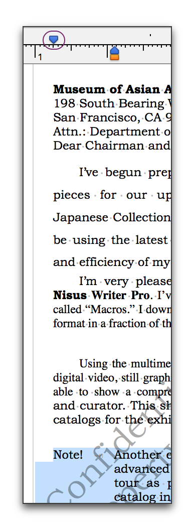

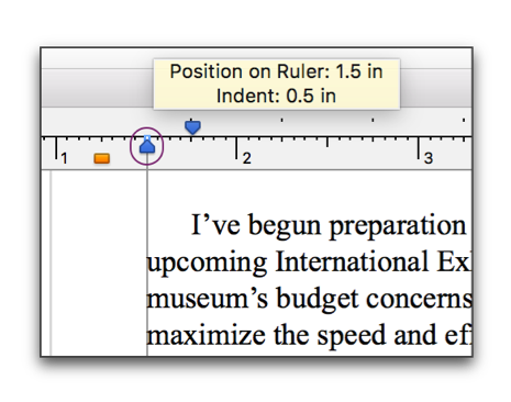

► Drag the First Line Indent and/or the Right Indent marker across the ruler and release the mouse button or trackpad where you want the lines of your paragraph to wrap.
0C2FEB46-CD02-468C-B2EB-F3215AD19FFB.png1D05543F-2B1C-4C80-88A8-9FBB66E028D8.png48E1AC49-210A-4443-9103-91D6D7988F63.png

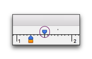

Figure 91
The First Line Indent in various positions relative to the
Left Indent marker

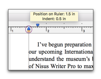

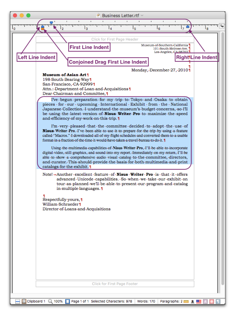

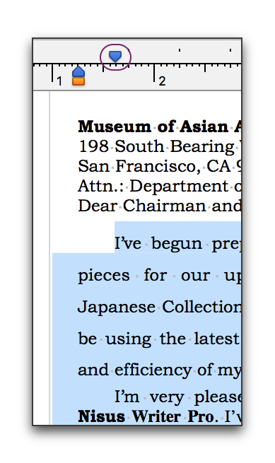

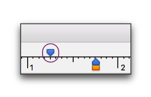

You can drag the First Line Indent marker independently of the Left Indent marker. If you drag the larger (upper) “Independent Drag” droplet, when you release the mouse button or trackpad, the smaller, lower “Conjoined Drag” droplet bounces into position. The First Line In/Outdent does not move.

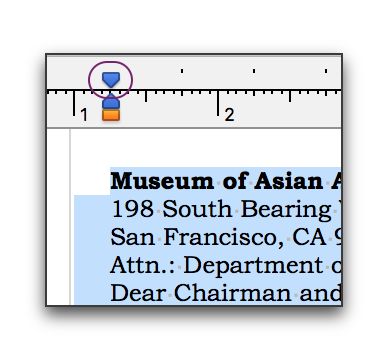

Figure 92
The Independent Drag First Line Indent marker
If you drag the smaller, lower “Conjoined Drag” droplet, when you release the mouse button or trackpad, the larger (upper) the “Independent Drag” droplet bounces into position and the First Line In/Outdent moves the same distance as you moved the Conjoined Drag droplet as illustrated in Figure 93.
F84F2823-9783-4CD6-97D6-951A106EAD9E.png9D1B7AD5-F2AB-4B44-AC06-7FC8110E9F1F.png9D26D179-64A8-45A3-BB1F-43579D20F265.png

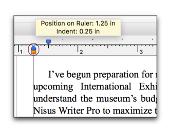

Figure 93
Moving the Conjoined Drag First Line Indent marker

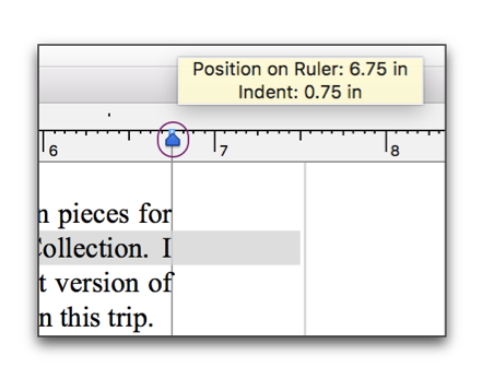

Figure 94
The
Right Indent marker
☞ You can select any combination of the four indent markers by pressing ⇧ or ⌘ as you click each one.
Figure 95
The Text
Wrap area

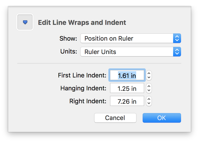

Set the text wrap area numerically
1. Double click any of the indent markers.
2. Enter the settings you want in the Edit Line Wraps and Indent dialog that opens.
You can display the values either as they appear
◦ from the edge of the paper: choose Position on Ruler
◦ or from the margin: choose Inset from Margin.
You can display the units either as they are preset on the ruler (Ruler Units), or any of the other units supported: Centimeters (cm), Inches (in), Millimeters (mm), Picas (pc) or Points (pt).
Figure 96
The Edit Line Wraps and Indent dialog in a left to right section
Figure 97
right to left section
3. Click OK.

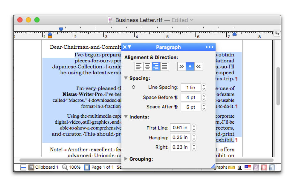

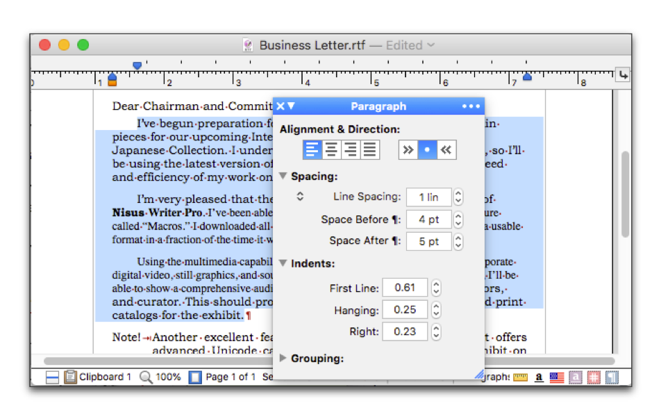

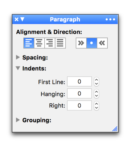

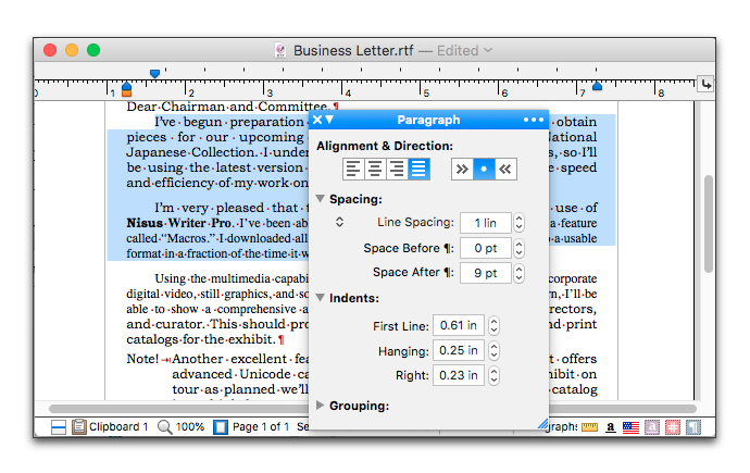

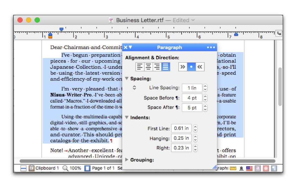

Set the text wrap area using the Paragraph palette
1. Click the Indents reveal triangle in the Paragraph palette as illustrated in Figure 98.
2. Select the text (lines or paragraphs) you wish to change.
3. Click the various “steppers” or enter the precise values to achieve the settings you want.
☞ Press ⌘ when you click a palette stepper’s up or down arrow to apply the shown value uniformly to all selected paragraphs, instead of adjusting all selected values independently.
Figure 98
The Paragraph palette with the Indents section showing
All of the indent controls are also available from the menu: Format > Paragraph Indents. However, they use preset amounts to increase and decrease the indents. You can have better control using the Paragraph palette, or manipulating the ruler directly.

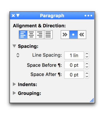

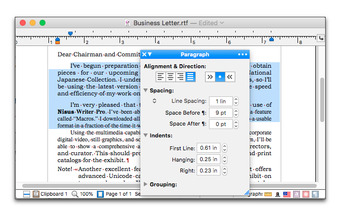

Use the Paragraph palette in the Palette Dock to set paragraph justification and specify how lines in a paragraph line up based on the left and right line wrap indicators. The choices are left, center, right, and full justification. Fully justified type causes uneven word spacing with even line widths, while unjustified (or “ragged”) type causes even word spacing with uneven line widths. You can also access these commands by choosing them from the menu Format > Paragraph Alignment.
Figure 99
The Paragraph palette with the Spacing section showing

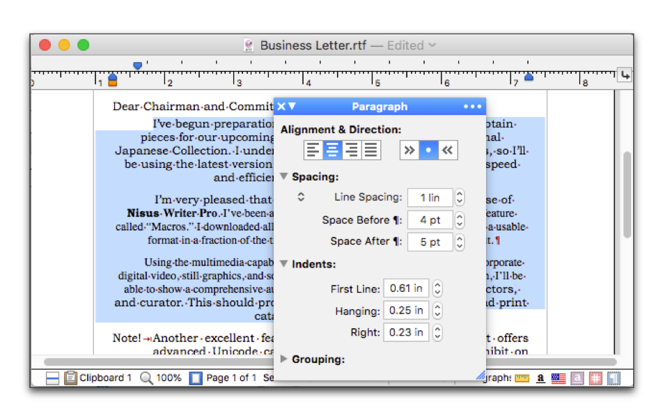

► Click alignment buttons on the Paragraph palette.
Alignment Buttons on the Paragraph Palette
Left align
Click to align text along the left indent marker allowing for a ragged right edge of text.
Center align
Click to center text around the midpoint between the first line indent and the right indent for the first line of a paragraph and between the two indent markers for all subsequent lines.

The following examples show how the different types of alignment affect your text with Show Invisibles (as explained on page 372) turned on.
Figure 100
Example of
Left Justification (with show invisibles turned on)

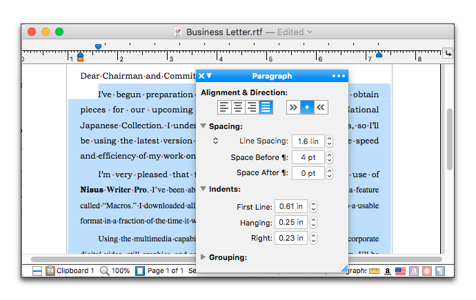

Set spacing between lines
Line height, known to typesetters as leading (because of the pieces of lead placed between the lines of type) refers to the vertical distance between the top of one line and the top of the following line.
Use options of the Spacing portion of the Paragraph palette illustrated in Figure 104 below to change the spread between lines, above paragraphs and below selected paragraphs.
► Click the “steppers” to apply varying amounts of spacing you want between lines and paragraphs or type the number of lines or points appropriate in the text edit box to the left of each “stepper”.
Figure 104
Change Line Height (with show invisibles turned on)
☞ The unit of measurement in the Line height edit box changes by .1 line increments to a maximum of four lines. You can select the text in the Line height edit box and type the number you want.

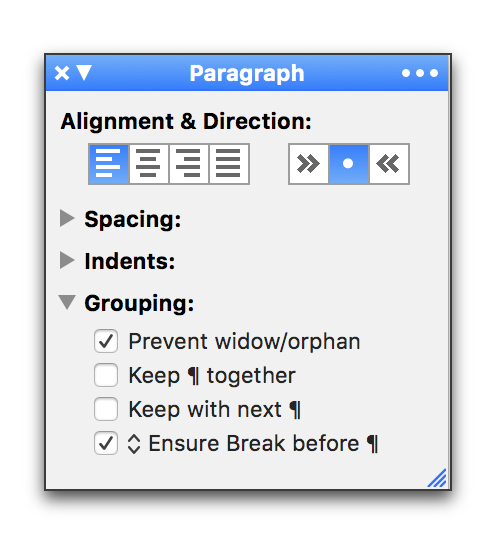

Control how paragraphs split and stick together
If you use Nisus Writer Express to put text on paper, you will probably want to make sure that the printed version of your file looks good. Among the concerns are whether headings remain with the paragraphs they introduce and other, similar issues. These tools are gathered in the Grouping section of the Paragraph palette illustrated in Figure 107. If you use any of these tools Nisus Writer Express adds a “Paragraph Grouping” invisible character in the left margin when the command Show Invisibles is turned on, as illustrated in Figure 28 on page 29. You can learn more about Invisibles in the section: “Determine whether or not “Invisibles” display in all new files” on page 372.
Figure 107
The Paragraph palette with the Grouping section showing

Ensure and/or force a break before a selected paragraph
If you have a paragraph that should be preceded by a break you can ensure or enforce that.
1. Click your insertion point in the desired paragraph.
2. Either…
▷ click Ensure Break before ¶
This means that Nisus Writer Express will make sure a page break exists before the paragraph. It will first check if there is a manually inserted break, and if so just let it stand. If no break character exists, then a break will be forced. Or…
▷ click Force Break before ¶
This means that Nisus Writer Express will always add a break no matter what, regardless of what comes before it. Even if there's a manual break character, a break will be added, resulting in two breaks.

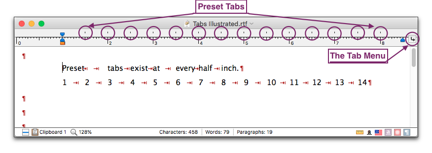

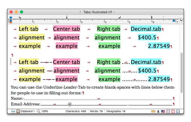

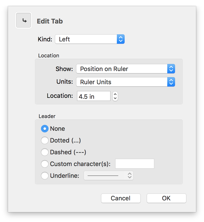

Set tabs
Use tabs to align columns of text. Pressing ⇥ lines up the text that follows at the next tab indicated above the ruler. Nisus Writer Express offers four types of tabs you can place on the ruler. The tabs differ in the manner in which they align text.
Automatic tabs appear every half inch after the last manually set tab.
Figure 108
Preset tabs above the ruler (with Show Invisibles turned on)

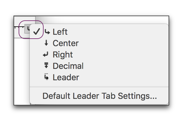

Set a tab visually
1. Choose the desired tab indicator from the Tab pop-up menu at the right edge of the ruler above the Vertical Scroll Bar.
The options available are:
◦ Left
◦ Center
◦ Right
◦ Decimal
◦ Leader
2. Click above the ruler where you want your tab to appear.

Set a tab using the menus
1. Choose the menu command: Format > Paragraph Indents > Add Tab Stop….
2. Choose the settings you want from the Edit Tab sheet that appears as illustrated in Figure 110.
3. Click OK.
Figure 110
The Edit Tab sheet (the tab style illustrated uses the Left Kind chosen)
Tab stop justification (with show invisibles turned on; with and without leader).png
Figure 111
Nisus Writer Express places no limit to the number of tabs you can set on a ruler.
If you do not set any tabs, you can use the built-in tab feature. Built-in tabs are left aligned.

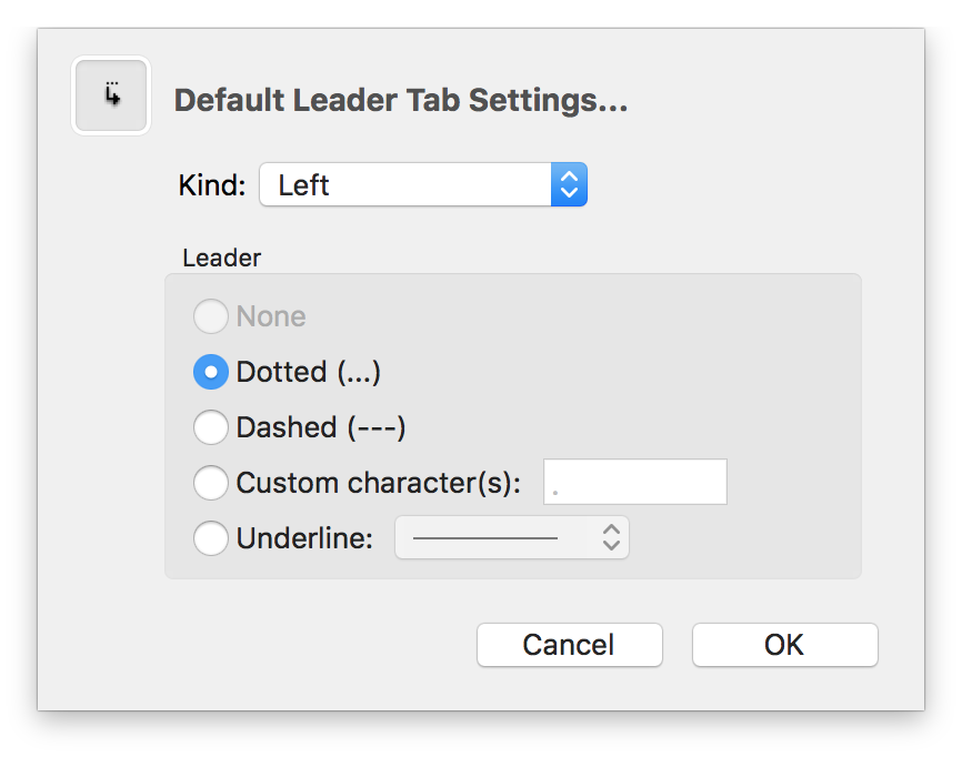

Use leader tabs
In tables of contents, indexes and columns of numbers you may want to have something to lead the reader’s eyes from one part of tabbed text to the next. These guides are called Leader Tabs. You can either set a series of Tab Indicators as Leader Tabs or change a plain tab to a Leader Tab at a later time.
► Choose the menu command: Tab > Leader and click on the ruler the same as with any other tab.
Set the type of leader before placing a tab
1. Choose the menu command: Tab > Default Leader Tab Settings….
2. Choose the kind of leader you want from the sheet that appears.
3. Click any one of the following
◦ None
◦ Dotted (…)
◦ Dashed (---)
◦ Custom character(s) (and enter the character(s) you want to use)
◦ Underline (and choose the style of line you want from the pop-up menu)
Figure 112
The Default Leader Tab Settings sheet (the tab style illustrated uses the Kind chosen)

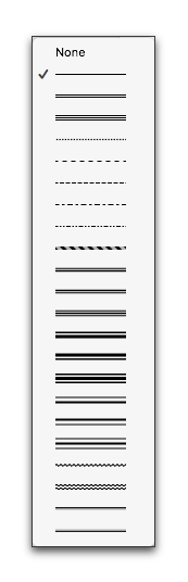

You can choose from a wide variety of graphic underline options from the Leader Tab Settings sheet.
Figure 113
Default
Leader Tab underline pop-up menu
4. Click OK.
Move a tab indicator using the mouse or trackpad
► Drag the Tab Indicator to its new location.
You can select multiple Tab Indicators then move them simultaneously if you press ⇧ or ⌘ as you click the Tab Indicators.
Nisus Writer Express displays a vertical line to indicate where the tab will align the text.

Edit a tab’s location numerically
1. Double-click the Tab Indicator.
The Edit Tab dialog indicates what kind of tab you have clicked and allows you to change it using the pop-up menu presented.
2. Enter the value for the location you want.You can display the values either as they appear
3. Click OK.
You can paste a numerical value into the dialog. This enables you to match a tab’s location in one part of your document with that from another part of the document.

Selecting paragraphs with different formatting
When you select paragraphs with different ruler formatting, the Ruler at the top of the document window and the Paragraph palette display the line wrap and indent, line height and paragraph spacing of the first selected paragraph. Other formats that are common to all selected paragraphs, such as Tab Indicators, also display. If you change the format to selected paragraphs with different rulers the new format affects all the selected text.
Set the same format for a group of differing paragraphs
1. Select the paragraphs
2. Change the format by modifying the ruler.
If the indentation differs for selected paragraphs, the Ruler at the top of the document window and Paragraph palette reflect the settings of the first selected paragraph. Changing an indent affects all selected paragraphs.
☞ The head and tail text wrap indicators determine the physical length of your line on the page. These markers determine where the lines of your paragraphs will “wrap.” Drag these indicators along the Ruler to change their settings.
