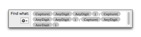

A metacharacter is a PowerFind command or symbol.10 Metacharacters denote a specific character or set of characters and can represent variables, number of repetitions, and so on. PowerFind displays the metacharacter symbols in a user-friendly manner using natural language words and phrases in a “bubble”. You can customize the color of these bubbles in your Appearance Preferences.
Figure 279
A PowerFind metacharacter or “bubble”

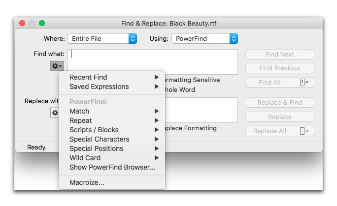

Use the “Find what” and “Replace with” menus
The Find what and Replace with menus present all the basic find and replace commands you might need to combine to create your Find or Replace Expression. In addition they contain submenus containing recently found and replaced expressions, as well as saved expressions, along with the tool to save them.
► Choose the commands you need from the Find what Gear pop-up menu or the Replace with Gear pop-up menu.
This puts the “metacharacters” that represent the expression in the Find what and Replace with text edit boxes.

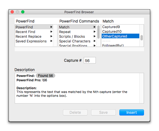

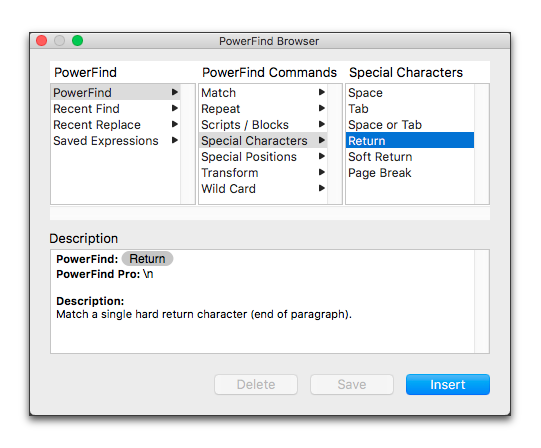

The PowerFind Browser
The PowerFind Browser is a floating window. It functions much as the Finder browser window. When you select from the commands on the left, new options become available in the columns to the right from which you can select more options.
☞ While it may appear to be a bit unwieldy, the PowerFind Browser is very useful because it can give you an explanation of what each metacharacter means. As you become more comfortable building your Find and Replace expressions, you may wish to use the menus as you graduate to PowerFind Pro.
Open the PowerFind Browser
1. Open the Find & Replace window by choosing the menu command: Edit > Find > Show Find….
2. Choose Show PowerFind Browser… from the Find what Gear pop-up menu or the Replace with Gear pop-up menu.
In addition to PowerFind Commands (as with the menus), the browser keeps track of Recent Find Expressions, Recent Replace Expressions and even Saved Expressions that you may have used at an earlier (no longer recent) session and decided to save.
Nisus Writer Express groups the PowerFind expressions into five sub-sets Special Positions, Wild Card, Match, Special Characters, and Repeat. When you choose an option from any of these columns, Nisus Writer Express inserts a graphic representation of the corresponding option in the Find what or Replace with box.
Resize the PowerFind Browser
The PowerFind Browser opens so that you can see all three columns of PowerFind expressions available. Below these expressions, two other areas appear
Repeat or Found #
These options only appear for two Find expressions (
N - M Times and N Times of the Repeat options) and in the Match expression OtherFound, or in the Replace expression OtherFound. An example appears in Figure 285 on page 321.
Description This area displays the selected PowerFind expression both in its PowerFind "bubble" as well as its PowerFind Pro text form. It also includes a brief description of what the expression would find.
► Drag the lower right corner of the window to make the window larger or smaller.

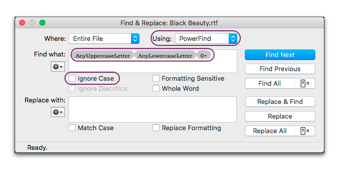

Find capitalized words (a PowerFind example)
1. Open the document you need to revise and move the insertion point to the beginning of the document or type the following into a new document
I went for a walk along the Atlantic City boardwalk and thought about all I had missed. A few hours earlier she had asked me to join her for a trip across New Jersey through Pennsylvania, Ohio, Indiana, the great Midwest and over the Rockies to the Pacific Ocean in California.
Then complete these steps.
2. Choose the menu command: Edit > Find > Show Find…, then choose the menu command: Gear > Show PowerFind Browser… beneath Find what.
The PowerFind Browser window opens to offer more capabilities.
3. Select PowerFind Commands from the PowerFind column, then Wild Card from the PowerFind Commands column and then UppercaseLetter from the Wild Card column to find strings of characters that begin with a capital letter.
You can double-click UppercaseLetter or select it and click Insert.
Or
◦ Choose the menu command: Find what > Wild Card > UppercaseLetter inside the Find & Replace window to find strings of characters that begin with a capital letter.
☞ As you insert the expression, the Using pop-up menu automatically switches from Normal Find to PowerFind.
4. Select Wild Card from the PowerFind Commands column and then Select LowercaseLetter from the Wild Card column to tell PowerFind that the word you’re looking for may contain some lowercase letters after the initial capital letter.
You can double-click LowercaseLetter or select it and click Insert.
Or
◦ Choose the menu command: Find what > Wild Card > LowercaseLetter inside the Find & Replace window.
5. Select Repeat from the PowerFind column, then 0+ from the Repeat column.
You can double-click 0+ or select it and click Insert.
Or
◦ Choose the menu command: Find what > Repeat > 0+ inside the Find & Replace window.
We know that most words have more than one lowercase character.
6. If it is checked, be sure to uncheck Ignore Case. Otherwise Nisus Writer Express will find all words whether they are capitalized or not.
Figure 283
Building the PowerFind expression
7. Click the Find Next button to begin the search.
Nisus Writer Express can find all capitalized words, one at a time.

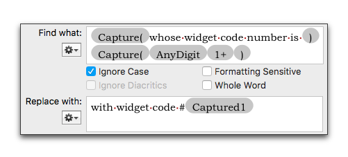

Capture() Causes the matched text it encapsulates to be available as one of the 'Captured' items either later in the search string or in the replace string. This expression is valid only in the search string, not in the replace string.
Found Appears only in the Replace with variant of the Match menu and represents whatever have been selected by Capture().

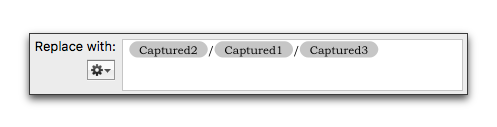

Captured1 - Captured10
Corresponds to that
numbered portion of the Find expression (built within parentheses), use in both Find and Replace expressions. Nisus Writer Express supplies the individual commands for 1 through 10. If you have additional encapsulated captured matched text you need to use OtherCaptured.
OtherCaptured
Corresponds to that numbered portion

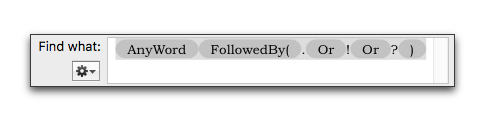

As an example, let’s say you want to find the last word in any sentence, but don’t want to select the punctuation mark itself. You could use the expression illustrated in
Figure 284. The FollowedBy() verifies that the word is FollowedBy() a punctuation mark, but does not include that mark in the match.
PrecededBy() is the same, but it verifies the nested expression exists before the following expression, rather than after.
Figure 284
The “FollowedBy” PowerFind expression

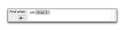

0 or 1 Zero or one occurrence
The expression illustrated in Figure 286 (find any A or any A followed by any B but only the first one that appears) finds A in AC and AB in ABB.
Figure 286
The “0 or 1” PowerFind expression

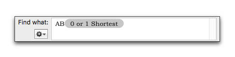

0 or 1 Shortest
Zero or one occurrence,
the shortest occurrence
The expression illustrated in Figure 287 (find any A followed by any B which must be there at least one (or more) time(s), but only the shortest string of them) finds only AB regardless of how many B’s appear.
Figure 287
The “0 or 1 Shortest” PowerFind expression

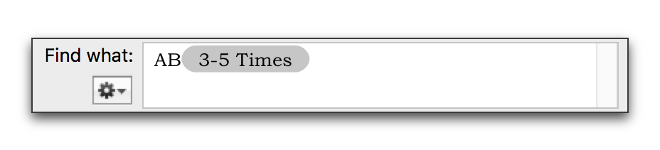

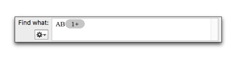

N Times Exactly “N” repeated occurrences
N - M Times
Between “N” and “M” repeated occurrences
The expression illustrated in Figure 289 (find any A followed by any B which must be there between 3 and 5 times; using N - M Times) finds ABBB, ABBBB and ABBBBB only.
Figure 289
The “N - M Times” PowerFind expression

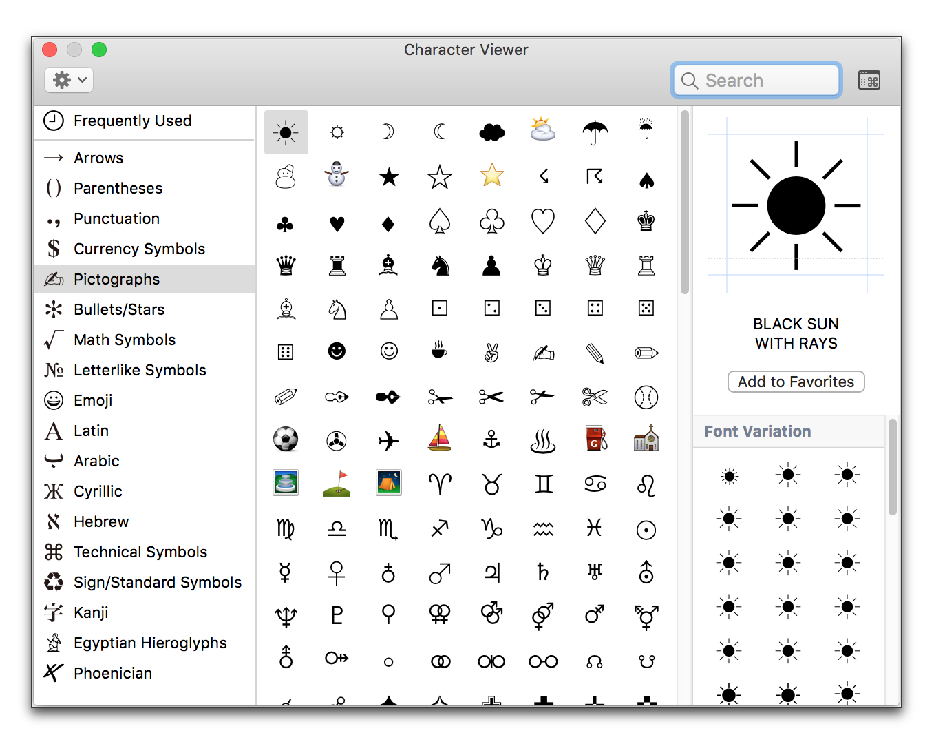

Finding and/or replacing non-Roman characters
Specify which Script (“language”) your text is in by choosing the appropriate language from the Scripts / Blocks set or:
1. Choose the menu command: Edit > Special Characters > Show Character Catalog… to open the Apple-supplied Characters palette as explained in “Enter Unicode text” on page 462 to find non-Roman characters.
2. In step 2 of the instructions there, instead of inserting the character in your document you will insert it into the Find or Replace window.
☞ This is not the “Character” palette that is part of Nisus Writer Express, which has controls for the font and other character formatting of your text.
Figure 290
The System's Characters Catalog (Viewer)

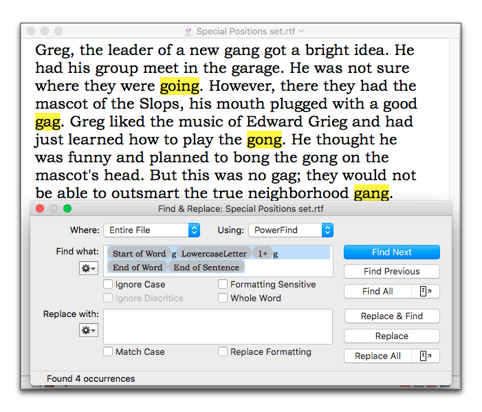

Special Positions set
Use options from the Special Positions set to determine the location of the beginning or ending of the Find expression.
Start of Word Matches the start of any word.
The expression illustrated in Figure 291 would find any word that begins with a “g”.
Figure 291
The “Start of Word” PowerFind expression
End of Word Matches the end of any word.
The expression illustrated in Figure 292 would find any word the ends with a “g”.
Figure 292
The “End of Word” PowerFind expression

You can see how some of these Special Positions metacharacters function in Figure 293 below. The expression finds all words that both begin and end with “g” and appear at the end of a sentence (going, gag, gong and gang), while ignoring all other words that either begin with but do not end with a “g” (got, garage and good), as well as all words that both begin and end with “g” but do not appear at the end of a sentence (Greg, as well as other instances of gang, gong and gag).
Special Positions set of Find:Replace expressions illustrated.png
Figure 293
Special Positions set of Find/Replace expressions illustrated

Examples of putting PowerFind to use
In the examples that follow, all instructions assume the Find & Replace window is open and PowerFind is selected from the Using pop-up menu.
Remove extra blank lines
These steps explain how to find every blank line and remove it.

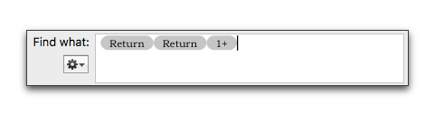

1. Choose Return twice from the Special Characters set, then 1+ from the Repeat set.
The Find box displays this expression in Figure 294.
Figure 294
The “Find 2 or more Returns” PowerFind expression
2. Click in the Replace with box and choose from the Gear menu: Special Characters > Return.
3. Choose from the Where pop-up menu: Entire File.
4. Click the left side of the Replace All button to remove all blank lines.

Change the sequence of a pattern
These instructions explain how to change all occurrences of a date entered as dd/mm/yy (for example 23/06/73) to mm/dd/yy. (or 06/23/73).

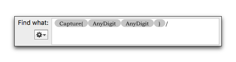

1. Click in the Find what box choose from the Gear menu: Match > Capture().
2. Be sure your insertion point is between the two portions of the “Capture” metacharacter.
3. Choose from the Gear menu: Wild Card > AnyDigit twice.
4. Type a slash:
So far, the Find expression is as illustrated in Figure 295.
Figure 295
The “Capture any two digits followed by a slash” PowerFind expression
1. Select what you see in the Find what box, then choose Copy then Paste it in twice.
2. Delete the final slash “/” to finish the expression so that it appears as illustrated in Figure 296.
Figure 296
The “Capture any two sets of digits separated by slashes” PowerFind expression
Here each set of the Capture and AnyDigit represents the two digits of the month followed by the slash “06/” then the day and slash “23/” and finally the year “73” the three things you want to find and switch.

3. Click in the Replace with box and choose from the Gear menu: Match >
a. Captured2
b. Type a slash:
c. Captured1
d. Type a slash:
e. Captured3
The Replace Expression should appear as illustrated in Figure 297.
Figure 297
A PowerFind replace expression changing a sequence of captured text
Nisus Writer Express uses the found text it “Captured” to define the numbered Captured groupings; that is, the first set of Captured text surrounds what will be produced in “Captured1”. The “Capture” stores the found expression so that it can be recalled when using the numbered Captured characters in the Match. In this example, the first Capture defines the two numbers, found in the text, not the symbols AnyDigitAnyDigit, to be recalled when Captured1 is used.
So, in the example, Captured2 represents the day (now at the beginning) and Captured1 represents the month (now appearing in second place).

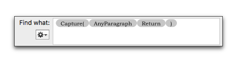

This exercise uses the PowerFind Browser rather than the menus of the Gear menu in the Find & Replace window.
1. Make sure your insertion point is in the Find what text box of the Find & Replace window, and it is empty.
2. Choose from the Gear menu: Show PowerFind Browser….
3. Double-click PowerFind > Match > Capture().
4. Place your insertion point between the two portions of the “Capture” metacharacter, if it is not already there.
5. Double-click PowerFind > Wild Card > AnyParagraph.
6. Double-click PowerFind > Special Characters > Return.

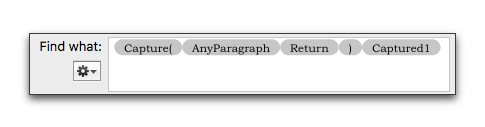

So far, the Find expression appears as illustrated in Figure 298.
Figure 298
The “Capture any paragraph followed by a return” PowerFind expression
7. Place your insertion point to the right of the close parenthesis of the “Capture” metacharacter.
8. Double-click PowerFind > Match > Capture1 so that Find what window appears as illustrated in Figure 299.

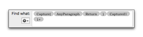

9. Double-click PowerFind > Repeat > 1+ so that the final Find Expression appears as illustrated in Figure 300.
Figure 300
The “Capture any paragraph followed by a return ’repeated once’ one or more times” PowerFind expression
You can use this expression to find and eliminate repeated paragraphs.
Change the wording of a repeated phrase containing a variable
Suppose your document contains multiple entries of the phrase “whose widget code number is #,” where # represents any of fifty different widget codes. The Find and Replace expressions below change this phrase to “with widget code #” without changing actual numerical values.
► Create the Find and Replace expressions illustrated in Figure 301.
Figure 301
A PowerFind expression that changes the wording of a repeated phrase with a variable

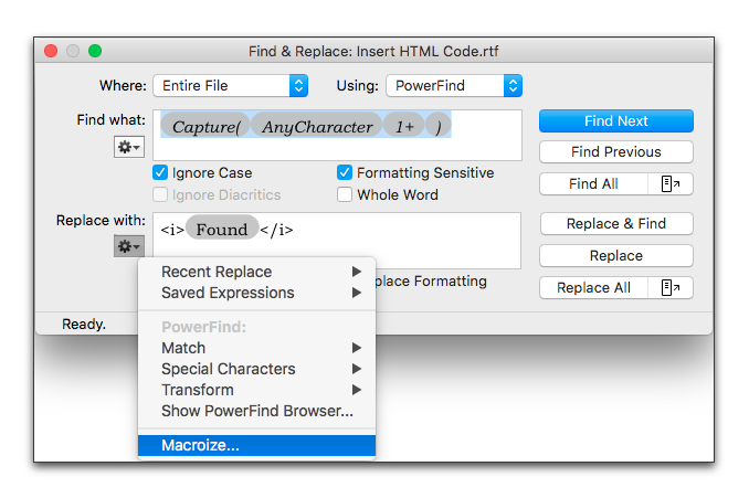

Convert Styles to HTML Code
With your document open choose the menu command: Edit > Find > Show Find…. The following steps will lead you through the process of creating the Find what and Replace with expressions illustrated in 1.
1. Choose PowerFind from the Using pop-up menu.
2. Choose the menu command: Gear > Match > Capture() inside the Find & Replace window.
3. Make sure your insertion point is inside the parentheses of the Capture expression and choose the menu command: Gear > Wild Card > AnyCharacter inside the Find & Replace window.
4. Choose the menu command: Gear > Repeat > 1+ inside the Find & Replace window.
5. Press ⇥ to move your insertion point from the Find what text box to the Replace with text box of the Find & Replace window.
6. Type the opening HTML tag you want.
The tag illustrated is
<i>
7. Choose the menu command: Gear > Match > Found (this time beside the lower Gear, beneath Replace with) inside the Find & Replace window.
8. Type the closing HTML tag you want.
</i>
9. Press ⇥ once again to select all the “text” in the Find what text box.
10. Apply the formatting you want to find (that match the HTML tags you’ve entered) from the Format menu.
11. Test your find/replace expression by clicking Find Next and then Replace a couple of times.
12. Now that you’re confident the pattern works correctly, click Find All to replace all matches.
