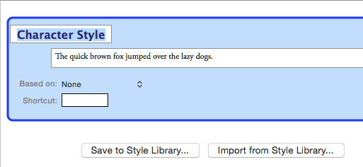

4. The Style Sheet View will be automatically displayed in NWP. It looks like this (see screenshot 3):
As you can see on the screenshot 3 the words "Character Style" are already selected. Give the new style a meaningful name, for example 'Mellel Style', by overwriting the words "Character Style".

4. At the bottom left of the Style Sheet click the plus sign to reveal a drop down style menu and check ‘Character Style’.
5. A new blank character style will be added to the Style Sheet with the default name ‘Character Style’ selected:
5. Overwrite the words ‘Character Style’ with what you want to name the character style. We shall retain its original name Scheherazade14. At this point Scheherazade14 will still be a blank style in the style sheet.
