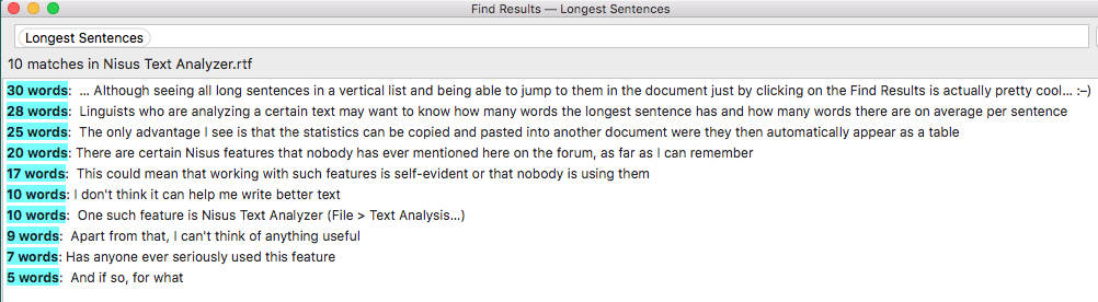

There are certain Nisus features that nobody has ever mentioned here on the forum, as far as I can remember. This could mean that working with such features is self-evident or that nobody is using them. One such feature is Nisus Text Analyzer (File > Text Analysis…)
Has anyone ever seriously used this feature? And if so, for what?

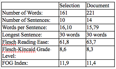

I don't think it can help me write better text. The only advantage I see is that the statistics can be copied and pasted into another document were they then automatically appear as a table. Linguists who are analyzing a certain text may want to know how many words the longest sentence has and how many words there are on average per sentence. Apart from that, I can't think of anything else that might be useful. … Although seeing all long sentences in a vertical list and being able to jump to them in the document just by clicking on the Find Results is actually pretty cool… :–)
Compare this with the first two pages of Heart of Darkness by Joseph Conrad. The text by Conrad has Flesch Reading Ease of 66,4, which I think means, it's easer to understand or read than my post above! That doesn't make much sense.

Thank you for reminding me about this feature, Þorvarður. I just checked my latest document, and the longest sentence has 62 words (or actually 58, since four words ending in a colon were included in the count). I will certainly use this feature once in a while to help limiting myself when my writing becomes too eager.

I use this feature a lot, as I work with a lot of people/families for whom English is not their first language. When I need to write for a general audience in English, I try to keep the grade level below 8. To do this, I often find I need to make sentences shorter as I tend to write in very long sentences, and often find simpler diction. It goes a long way to make my work more effective.

I'm glad to learn that people are finding this tool in Nisus Writer Pro. I requested this tool about 25 years or so ago when writing the Nisus documentation. I was concerned that I was writing run-on sentences and thought such a tool might help me find and correct them. And indeed that has beeen the case.
