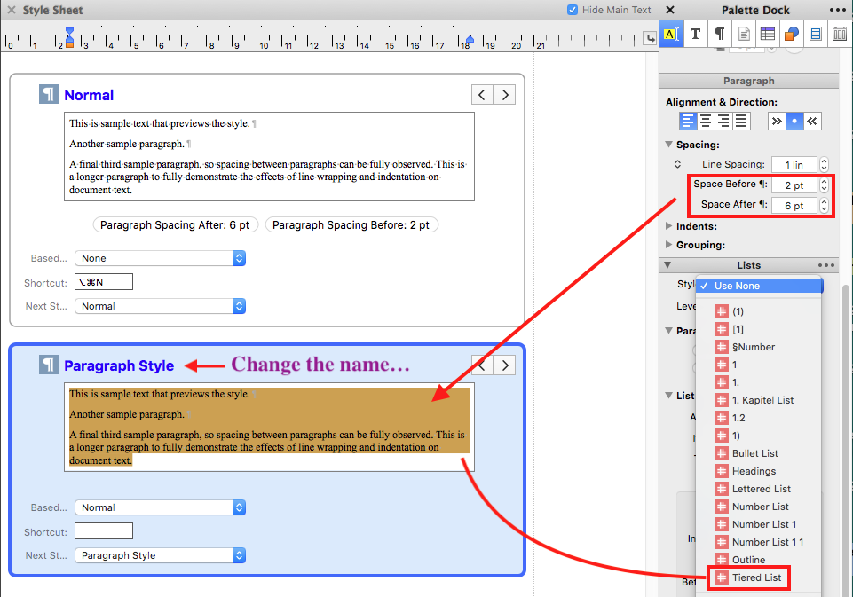

There are those here who might give you a more informative explanation, but my take is that it is, in a sense, a question of naming.
As I see it, "List Styles" should perhaps be thought of as "List types" (the same goes I suspect for "Note Styles"). From experience here and with other apps built on Apple TextKit, the "List styles" are actually based on the listing framework provided by the TextKit, not "styles" like "Paragraph/Character Styles". The framework must provide automated tabbing and bullet/numbering options, but have no hooks for line spacing, font size, etc. Look at TextEdit, which is basic TextKit; you'll see it can do lists and basic tables, but no "styles"… they have to be programmed as necessary by the developer of any app based on TextKit.
The result is, as you see, you can't add paragraph/character styling to the "List Styles", but you can apply apply "List Styles" to "Paragraph Styles". Therefore, if you want your list items to have a different font family/font size/line spacing to your "Normal" settings, you need to create paragraph styles and apply the desired "List Style" to them.
HTH
HTH
