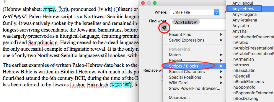

Is there an easy way to search/find any characters in a large document which are Hebrew?

Another easy way is to use AnyHebrew from the Scripts/Blocks menu.
