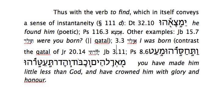

Second, Following what Martin said, I used this http://ocp.acadiau.ca/kpenner/convert.htm site to convert your text to unicode. I think they have some bugs in the transformation as some Nikud characters are wrongly transformed. but nevertheless, when I pasted the converted text back into your file, the direction was ok, with no hidden characters whatsoever. I enclose here a screen snapshot of your file after I have transformed part of it. ignore the mistakes (they are not mine

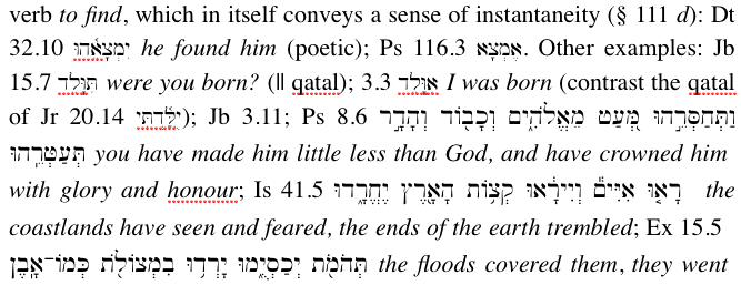

Thanks for all of your help. I found a solution for the font issue. It's very easy, just insert U+202E and U+202C to enclose the hebrew phrase, than it will be reversed, also the word order is correct when line wrap. However, the HebraicaII have 2 glyphs which latin character is '[' and ']'. This will have some problem, because in the RTL phrase, they exchanged. While I change them back, I got extra space for each '[', this will separate a single hebrew word to 2 or 3 words depends on how many '[' char the word have. So my solution is to use Yehudit font, Accordance's hebrew font, '[' and ']' are used to represent them self, not other alphabet. Here is the screenshot.
