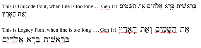

Thank you both for your help. If I use legacy font instead, how to make the Hebrew phrase in correct order when line wrap ? I have few documents contain more than 5000 hebrew phrases in legacy font. It is ok to use unicode font, but it takes lots of time. Do you have any idea ?
圖片 4.png (21.13 KiB) Viewed 39475 times

Post by Ruchama »
As far as I know legacy fonts' format is suitable for system 9 (pre osx). that is probably why the system recognizes the wrong direction. I am not sure what do you mean "it ok to use unicode but it takes a lot of time" - to you mean the replacement? I think this can be performed by powerfind quite easily and fast..
I have never tried it, but maybe inserting directionality change mark ( at the beginning of each verse) will solve the problem? Even is so, I would not recommend it as when you exchange documents with other users you are bound to have problems.

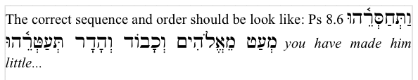

Attached is a sample paragraph of my documents. These documents were created by Nisus 6, and I use Nisus Pro 1.2 to read and save as rtf file. What I want is the sequence in following pic, even in legacy font or unicode font. Any suggestion ?
圖片 5.png (16.22 KiB) Viewed 39435 times

Ruchama
Posts: 213
Joined: 2006-08-19 18:35:27
Re: Hebrew font problem
Post by Ruchama »
do you still have the original nisus 6 file? how did you open it in nisus pro?
I am asking because I can not see any hebrew in the file, and no conversion works for me. However, original nisus 6 files shouldl be convertible to nisus pro, even if with some bugs..
