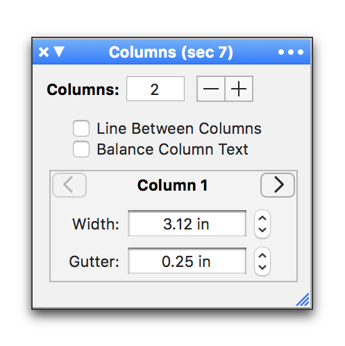

The Columns
palette
1. Open the Columns palette.
2. Type the number of columns you want your document, or section, to have in the Columns field at the top and press ⏎, or, click the Minus (-) button or the Plus (+) button to decrease or increase the number of columns.
Set column line
Nisus Writer Express can draw a line between your columns.
2. Click Line Between Columns.
Set column and gutter width
Nisus Writer Express allows you to set a different column width as well as gutter width between each column.
1. Click the forward or backward button to decide which column you want to modify.
The number of the column appears at the top of the bottom half of the Columns palette. This is not the column in which your insertion point appears.
2. Click the up-pointing or down-pointing triangle in the “stepper” to the right of Width or Gutter to increase or decrease those settings accordingly.

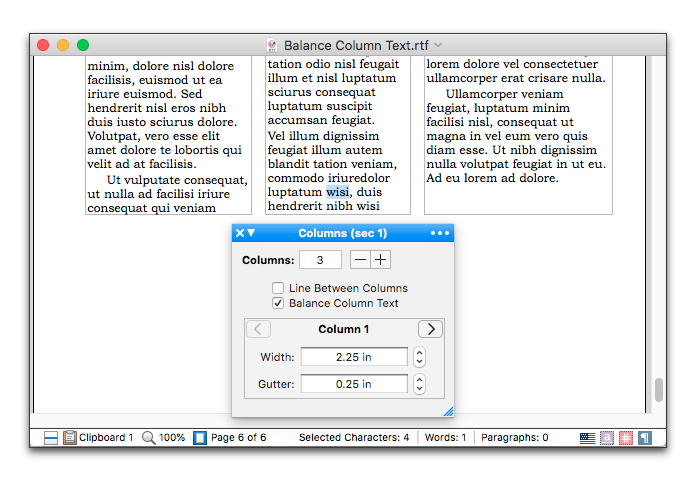

Figure 152
Column text balanced
☞ The gutter controlled is that to the right of the column indicated in the palette. So, in the document illustrated in Figure 152 above the .25 inch gutter refers to the space between the second and third columns.
Balance column text
Nisus Writer Express can balance the amount of text in the columns of the last page of your document as illustrated in Figure 152 above.
2. Click Balance Column Text.
