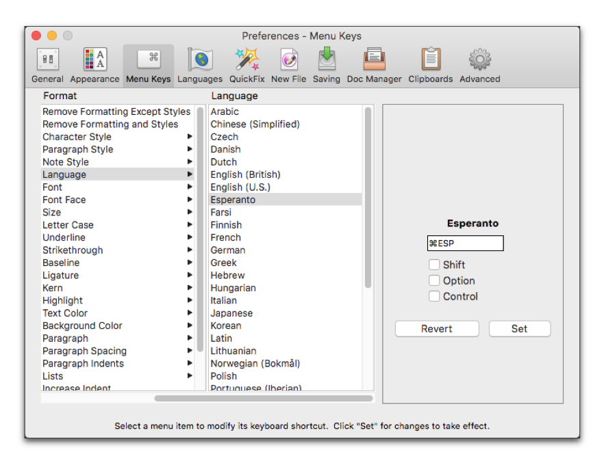

1. Choose the menu command: Nisus Writer Pro > Preferences > Menu Keys at the top of the dialog to customize the keystroke sequences to any menu command.
This a menu “browser” (like the “file browser” in the Finder).
Figure 499
The Menu Keys section of the Preferences dialog
2. Choose a command from any menu.
3. Type the keys you want to use to call that menu command. In addition, you can add any of the modifier keys to achieve additional combinations.
► Check Shift to require ⇧ to be part of your keyboard shortcut.
► Check Option to require ⌥ to be part of your keyboard shortcut.
► Check Control to require ⌃ to be part of your keyboard shortcut.
► The Numbers Keypad (for those who have one) functions the same was as if it were one of those on the number row (above the “qwertyuiop[]\” row). However, you cannot use the Numbers Keypad keys in conjunction with the alphabetic or numeric keys of the remainder of the keyboard for a shortcut.
4. Click Set to confirm your keyboard shortcut.
