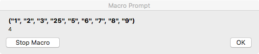

I decided I would try some testing to get a better understanding of the new "Ref" objects in NWP 3.0. So I tried the following:
$values = "123456789"
$grid = $values.split('')
$cell = Ref.new($grid[3])
prompt $grid, $cell.value
$grid[3] = "25"
Imagine my surprise when I got the following result:
I can't really make any sense of this. I thought the whole point of a Ref was to point at the object, rather than copy the value, which in my understanding should mean that it tracks changes made to the object later. Does
$grid[3] = "25"
really create a brand new text object and leave the prior "4" stranded? :?
I also tried changing $grid[3] = "25" to $grid[3] &= "25" (with the idea that there might be difference between "new assignment" and "modifying an existing value"), but the result was no different.

After writing the above, I guess I'm going to try to answer my own question.
Presumably NWP text objects are immutables, and an array is (something like) a linked list. So every change to a text object really does create a brand new object and the linked list is just updated to have its (in this case 4th) item point to the new object. The Ref object keeps pointing at the original text object.
I'll have to mull over this some more :drunk:
That's functionally correct at least as far as the array is concerned (though arrays aren't necessarily implemented as linked lists). Your array assignment statement ($grid[3] = "25") is merely changing the array itself. Your code doesn't access or modify the Ref you created.
