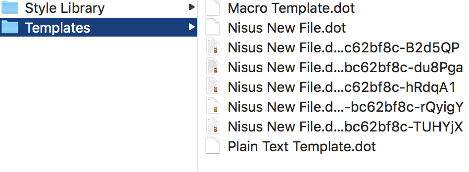

So I defined the main default for a new document in Preferences/New File/Advanced I chose a New Life set in Documents, which I named Nisus Documents.
The result being :
Screen Shot 2018-09-15 at 17.17.45.png (92.93 KiB) Viewed 41830 times

. . . which appears within Desktop/Documents/Nisus Documents

So, here is the question: do you see anything weird in this window ?

It sounds like your general approach is correct. That is, it's perfectly normal to establish a Document Manager folder for Nisus Writer in a location like ~/Documents/Nisus Documents.
But from your screenshots something might be amiss. Normally when you see gibberish file name suffixes like that it indicates a problem with in-place autosave. This could be a problem with Nisus Writer, or the Mac system. We don't actually handle any of the final file swapping and those temp files with the odd filename suffixes. That's all transparently managed by macOS to safely swap your files on disk when saving a new copy.
However, in general I wouldn't be too concerned about those kind of temp files. Probably a crash occurred in the middle of an autosave or something like that, leaving a stale temp file. Unless you are missing data, I would trash the temp files.
So, the question remains: what is the actual problem? In other words, what are you trying to achieve exactly? If you are trying to customize the new file template, you should visit Nisus Writer's preferences and switch to the "New File" pane. Once there you can either customize individual properties of the file (eg: the default font) or choose an entirely new template file.
If you still have any problems or questions please let me know. It would help to know what you're trying to do, and exactly what steps you're using.

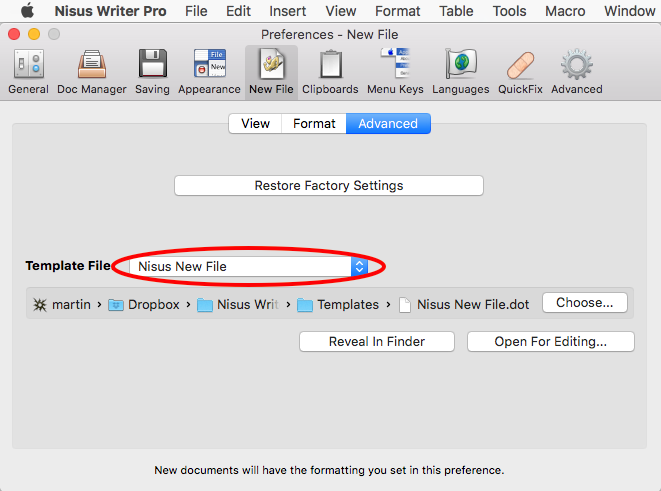

Re: Install
I'm very happy to help! Thank you for the clarification. It sounds like you just want to customize the New File template a bit beyond what's offered by our controls in the preferences. That shouldn't be too difficult.
Basically what you want to do is open your Nisus New File template for editing. Once you have the template document open in Nisus Writer you can make arbitrary changes like customizing your styles, headers, window size, etc.
Here's the basic workflow:
1. Open Nisus Writer's preferences window.
2. Switch to the "New File" pane.
3. Switch to the "Advanced" tab.
4. Make sure the "Template File" is set to "Nisus New File".
5. Click the button "Open For Editing". The template document window opens on screen.
6. Make any and all changes you want to the template, save it, and close the template document window.
That should do it. Please let me know if you have any troubles or questions.
Oh and here's a screenshot of what you should see right before you click the Open For Editing button:

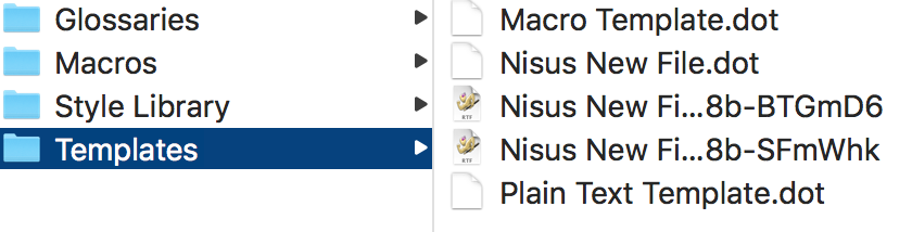

trying again and I do not get the new settings, instead in the Nisus Document/Templates, I get this:
Yohanan

I am not able to place the screen shot in this place, sorry.
Screen Shot 2018-09-20 at 10.40.27.png (61.75 KiB) Viewed 41638 times

well. . . apparently I was without knowing it. :D
