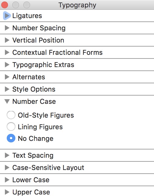

You have to remove "Typography Options" from the footnote reference character style.
That will remove the old-style figure option which is now applied to that style.
Under Number Case select No change while that style is selected in the Style Sheet:
Number Case options.jpg (71.62 KiB) Viewed 15307 times

In my file, within the Character Style dialogue box, I’ve pulled up the “Typography Options” dialogue you’ve mentioned, and the option “No change” for Number Case is in fact already selected.
But when I click the “No change” option again, a “Baseline: +4pt” option gets added to the character style, as follows:
Typography_Options.pdf
(63.12 KiB) Downloaded 886 times
Consequently, in the text the footnote references 2 & 3 fly away up into the air.
In the document you kindly posted (which has added a baseline skip of +3pt to the character style), I don’t know if you can see it but there is a notable difference between the size of the footnote references “1”, “2”, and “3”. Number “1” looks right (but it hasn’t been affected by any of this), but both “2” and “3” appear to be too big. There is something going on here that I can’t understand.
