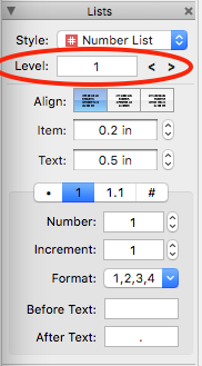

One possible reason for the unexpected list numbering restarts: changes in list level. Even if you have the same list style applied consistently for all your figure captions, perhaps a stray caption is not configured at the same list level? You can check by selecting a list item and looking at the Lists palette's "Level" field.
If you still can't figure out the cause of the incorrect numbering, please do send us a copy of your document and we'd be happy to have a look privately. Whenever you have time of course. I hope your husband's illness is not serious, and that he's feeling better.
