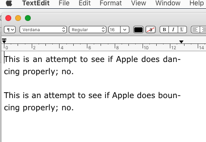

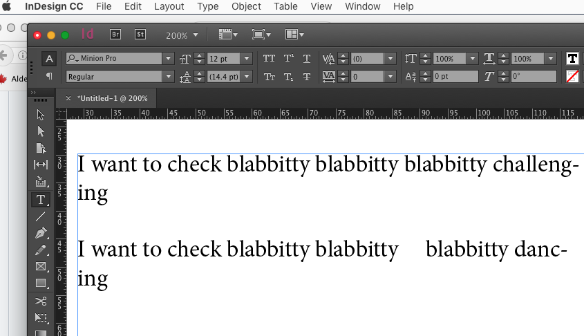

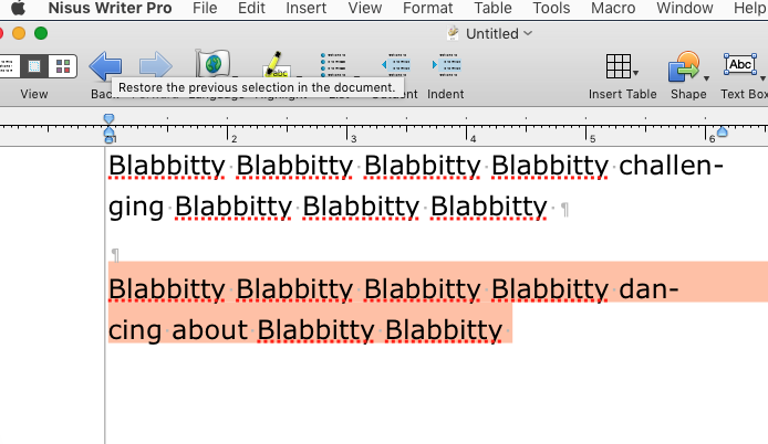

martin wrote:I'm not seeing this problem. I tried on OSX 10.11 with the settings you gave, in a small test document, and "challenging" is hyphenated correcting as challeng-ing.
This is very strange, because I'm on 10.11 and I've just tested both Nisus and TextEdit, and both have the errors in multiple words.
Whereas inDesign does it correctly. All on my 10.11 system.
See the attached screen shots.
I'm having a hard time imagining something that would cause Apple's engine to do this in my version of 10.11 (which is 10.11.6, on an iMac) and not yours, but apparently that's so.
Nisus Apple error in challenging and dancing hyphenation.png (63.16 KiB) Viewed 11974 times
Text Edit (El Capitan) error in dancing and bouncing hyphenation.png (31.18 KiB) Viewed 11974 times
InDesign correct hyphenation of challenging and dancing.png (79.12 KiB) Viewed 11972 times
Re: Nisus/Apple breaking at non-syllables, off by 1 letter
withoutFeathers wrote:I'm having a hard time imagining something that would cause Apple's engine to do this in my version of 10.11 (which is 10.11.6, on an iMac) and not yours, but apparently that's so.
Strange, but apparently true. I just tried again using "dancing" and other words as you did, but do not see the problem. I suspect InDesign has its own hyphenation engine, so that's why it's not affected.
You could try installing additional English hyphenation dictionaries, which Nisus Writer can detect. I found some extra English hyphenation dictionaries on a LibreOffice web page. You'll want the file called hyph_en_US.dic or hyph_en_GB.dic. Then follow the instructions in our FAQ topic to make them available in your Nisus Writer preferences. That should allow you to sidestep whatever hyphenation problem you're seeing with Apple's engine.
