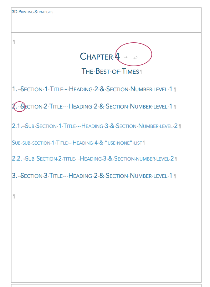

Also, when I rebuild the TOC I get chap 3, 4, 5, 6 and appendix 1 & b duplicated at the end of the TOC! This ones new, I haven't had this happen before.

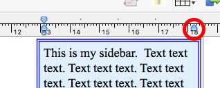

From the sound of it you want borders and/or shading on your sidebar paragraphs. I would recommend using the paragraph formatting options for this rather than trying to draw (floating) rectangles and trying to place them. Floating rectangles will have the same drawbacks as text boxes, plus you need to resize them every time you edit your paragraph.
One further option is to use tables. One cell tables can sometimes be a good option. But since Nisus added paragraph borders and shading, they seem the preferable method.
I am attaching a sample here, that has sidebars using a paragraph style.
I'm sorry to hear you are having such a hard time.
You are calling these things "sidebars", but you want them to have the full width of the page and margins that match the page? From the sound of this, I wouldn't choose text boxes for this kind of thing. Text boxes are a good idea only for text which should "float" independent of the main text, or overlap the page margins, etc. Of course if you want consistent formatting of floating text boxes (exact width, exact location, etc.) I would suggest to use the control palette and enter numbers. You can select all text boxes at the same time and enter the number(s) and all text boxes will then have the same value. That's a much easier, quicker, and more precise way of getting things to align. But like I said, it sounds like text boxes are the wrong thing for your casemhackney wrote:Initially I tried using Text blocks for my sidebars with a light blue background. Formatting the blocks so they are a consistent width-the width of my page-is a bit of a challenge. The margin fields for the block don't always correspond to the actual page margins so I have to position by hand. Using the mouse to drag sometimes works but often causes the block to jump to another page. Very odd. I ended up abandoning using text blocks and now just insert my sidebars inline where I want them using a different face. I use a rectangle object with a blue fill and position it behind the text. I have to manually align these and even though I try to anchor to the sidebar text/paragraph itself, the anchor doesn't stay put. Every time I touch the file, a few of these boxes will move up or down a little (say 2 lines or so) and throw the layout off.

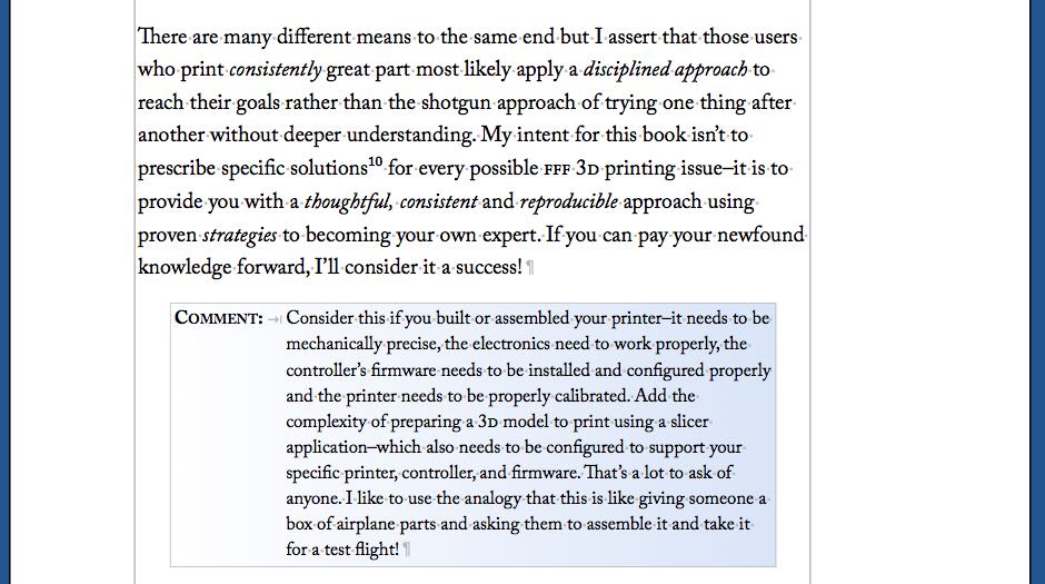

G’day, Michael et al
Very quickly on that small caps issue….
A search for “fff” in your document yields no results. A search for “ff” selects only the last two characters of a triplet. Double-clicking on an occurrence of “fff” also selects only the last two characters of a triplet. This behavior suggests that the triplet is not recognized as a single word.
View > Show Invisibles
Gotcha! Interposed gremlins.
Editing > Select > Select All (Cmd-A)
Macro > Editing > Zap Gremlins
Correct behavior supervenes.
Why the gremlins were there in the first place is not something I understand, but it could be a function of the font you are using. I see it is ACaslon Pro which is not one I have on my computer and so was substituted. Which does raise the issue of whether the gremlins were inserted during the substitution at my end, but I suspect this is unlikely.
Anyway, see if the above works at your end.

Wow, I learned some new things! Thanks.
I duplicated your steps but after the Gremlins (12 of them I recall) were removed, I still am not able to make all 3 "f" small caps. Take a look at the zoomed in screenshot, it looks like the first one is slightly different from the other two! Yet they are the same font and style. When I double click, all 3 are selected like a word (correct behavior). But applying small caps only affects the last f.
I've even deleted that entire sentence and re-keyed it. I wonder if the "fff" sequence is being treated as a special thing?
- Screen Shot 2017-02-26 at 6.04.31 PM.png (24.21 KiB) Viewed 29911 times
Re: Lot's of formatting issues
It must be the Adobe Caslon Pro font, if I change those 3 characters to any other font it works perfectly. I also see that the sequence ffm also doesn't behave properly - it's the "ff" that seems to be the problem. I suppose I can create a character style and use a different font and small caps to deal with this.
While I have your attention, is there a way to remove unused fonts from the Document Fonts menu?

G'day, Michael et al
Good to hear that you've purchased Nisus Writer. I hope you enjoy using it.
Personally, if I found a font so problematic, I'd switch to another one. But there are ways of addressing the problem if you are otherwise wedded to that particular font.
Presumably you will introduce a gremlin every time you use that ligature. Simply applying a special style will not by itself remove the gremlin. I would create a macro to do the job for me. Quick-and-dirty code might be along these lines:–
I've chosen Palatino, but you could substitute some other font. The "To Small Caps" command comes from the Edit > Convert menu. If you wanted to, you could add in colors, underlining or anything else that took your fancy.
Duplicate any file in your Nisus Macros folder, replace its contents with the above code, and save it with a recognizable name somewhere appropriate in the Macros folder.
You might run this macro (from the main menu or via a keyboard shortcut) every time you entered the ligature (if you wished to see it in all its new glory immediately), or you might run it when the document is all but complete. Just remember that Find/Replace expressions involving the ligature may not work as expected, depending on the state of the document at the time and your choice of F/R expression.
When it comes to removing unused fonts from the Document Fonts menu, the program should do this automatically. However, when I converted all text in a test document into a single font, the Document Fonts menu still listed some other fonts. I had deliberately ensured that the header and footer contained no stowaways. Mystery! Eventually I discovered that they lurked amongst the styles in the Style Sheet. So there’s a few clues about tidying up that menu. Real rainy-day stuff, in my opinion! (And it doesn’t rain that much where I am!)
I hope all this helps.
# Zap any gremlins.
# Based on code in Nisus Writer's Zap Gremlins macro.
$gremlin = '[\x00-\x08\x0B\x0E-\x1F\x7F-\x83\x86-\x9F]'
Replace All $gremlin, '', 'Ea', 'a'
# Apply desired character formatting to a particular string.
$pesky = "fff"
Find All @String($pesky), 'Ea'
Palatino
To Small Caps

I put a fair amount of time into choosing the font for this book and this one was "perfect'. It's an Adobe font so I thought it should be clean. The ONLY issue I've found is this odd combination of "ff" followed by another character. I ended up creating a character style that changes the font to Garamond and small caps. It works perfectly and I don't have to find another font to use!

I'm not sure I did anything special here. Paragraph Borders do fall on the "outside" of the paragraph, so at the margin you have to move the text wraps in just a hair.mhackney wrote:As it is, as you can see, I still don't know how to fill that color to the right margin and also provide a little margin around all of the text like Philip's sample. But I see that he pulled it off so I'll keep looking until I find out how to do it!
I think, considering what you were trying to do, that floating text boxes would have been the obvious choice. But since it also looks like your "tips" can get a bit long this is likely to cause placement issues. A text box is usually attached to the beginning of a paragraph. If the paragraph starts near the bottom of the page, a large text box might not fit, and then Nisus "goes crazy".mhackney wrote:Note, I [use sidebars] primarily for "tips" and other text that is not part of the main document flow so I do want some visual distinction but I'm not married to a particular construct (true sidebars, etc) as long as it is visually appealing and doesn't cause overall formatting headaches.
My recommendation for such cases would be to first create the "tips" inline, as you are doing now, and then use a macro to place them into text boxes once you are ready to print. After running the macro you would then go through the document and adjust the vertical placement and put "strategic" page breaks to help with the placement of the boxes.
But as you discovered, text boxes have other drawbacks as well, such as not allowing for footnotes. If you need footnotes in text boxes you will have to use a workaround. See similar discussions for tables, which (spoiler alert) also do not allow footnotes.
The (only) way to do that is to set the margins wider and then move the text-wrap(s) in. If you do this for your Normal style—and have all other styles based on Normal—this should give you some space to let things "stick into the margin". However considering that you are using odd/even pages with unequal margins, I'm having a hard time wrapping my head around how you would need to set things for everything to come out right.mhackney wrote:My goal really is to have a place visually distinct from the main body of text to add in tips and rants/raves (well, I call them soapboxes). Philip's approach works fine with a little indent on the left and right. If there were a way to move the outer page margin for these so they could actually extend out in the whitespace like a real sidenote, that would be cool but I like what I have now.
So in rethinking the heading numbering...
I need to be able to have some headings numbered - chapter names, primary headings like 1. XYZ, 2. ABC. But I don't like to go deep with dot-numbers so on the next level I prefer not to have a number at all. I never (at least in this book) go deeper than that. This makes for a very clean looking table of contents and allows be to use the 3rd level heading.
----- Typical Chapter Structure -----
Chapter 1
First Chapter Title
1. Section 1 Title
2. Section 2 Title
2.1 Sub-section 1 Title
Sub-sub-section 1 title (no #)
Sub-sub-section 2 title (no #)
2.2 Sub-section 2 Title
All of these headings are in the same font, which is different than my body text font. Also, I,d like each of the levels styled uniquely - decreasing font size and lightening of text color.
There seem to be a number of ways to go about this and I've started to implement but I'm convinced it isn't very elegant and might lead to issues later. But I can't seem to wrap my mind around how to set up Heading Paragraph styles and corresponding levels to pull this off. It seems like this might work:
Base Heading Paragraph: create a Heading Normal base paragraph style with my heading font and small caps.
Chapter Headings: configure Heading 1 based on Heading Normal and centered, large and numbered sequentially throughout document using a new list style called Chapter Number which has the Before Text set to "Chapter".
Section Headings: configure Heading 2 based on Heading 1 and left margin aligned with smaller text and lighter color and using a new list style called Section Number that is a simple numbered list with indent Number: 1.
Sub-Section Headings: configure Heading 3 based on Heading 2 so I can reduce the font size and change the color slightly and use the Section Number list with indent Number: 2
Sub-sub-section Headings: configure Heading 4 based on Heading 3 to reduce font and change color and set List Style to "use none".
I've implemented this in my sandbox document - see screen capture. Assuming this is a reasonable approach (best practice?) I have 2 questions - see red circled areas.
There is a Tab character after the "Chapter 4" that throws off the centering with the soft return (by the way, I use a new character style for the second line to reduce the font size "the best of times"). I looked everywhere and do not see how to remover that. I *thought* the Lists Separator: would do that but it doesn't seem to.
I'd like to replace that Tab with a space or En Space but again the Lists Separator doesn't seem to do it, I can add a space after the '.' but it still puts the tab after the space.
Am I on the right track with the above or digging myself into a pit?

- Screen Shot 2017-02-27 at 10.45.37 AM.png (82.35 KiB) Viewed 29854 times
