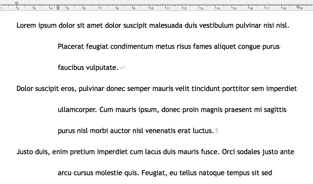

Hello,
I just updated to Sierra and now my old Nisus documents are wrong formatted: The indent after a soft return is ignored. Before Sierra the first line after a soft return was also indented just like the second line. Now the first line after a soft return starts like after a hard return from the beginning.
Am I the only one with that problem or is it common?
Enclosed a snapshot.
Ulrich
Re: Second line indent after Soft return and Sierra
This appears to be a new bug, specific to using soft returns with a hanging indent on macOS 10.12 Sierra. Thank you for reporting it to us, and sorry for the trouble.
We don't have a workaround at this time, but we're looking into the matter.
If you don't mind trying pre-release software, you could download the Nisus Writer Pro 2.1.6 beta, which fixes this issue.

The final release of 2.1.6 solves my problem. Thanks a lot, Martin!
