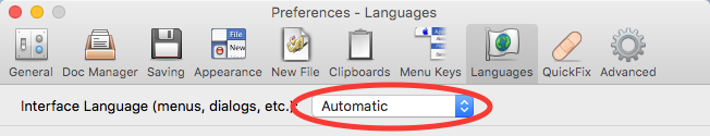

It's easy to change the language used in Nisus Writer's interface (menus, dialogs, etc). Just follow these steps:
2. Switch to the Languages pane.
3. At the top, change the "Interface Language" setting.
4. Quit and relaunch Nisus Writer.
