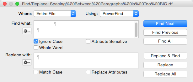

tommyzai wrote:Uh oh! I just used the find and replace to remove all blank lines and made a mess.
It looks like you accidentally replaced all newlines with nothing. You want to replace all double returns with *single* returns. You'll want your Find & Replace dialog to look like this:
Or if you're using PowerFind:
tommyzai
Posts: 9
Joined: 2016-03-23 10:21:09
Re: Adjusting Line spacing between paragraphs, but not text?
Post by tommyzai »
Fantastic! All lines are removed. Forgive me for asking, but may I ask for some tips on adjusting the styles to create some space. I'm not sure how to go about this. I do know where to find the style edits, but not sure where the rest is. I'm concerned that adding space before and after would double up spacing where paragraphs meet.
