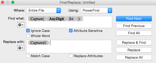

I would like to take text like the following and put the bold numbers (which can be up to three-digits long, e.g. "150") in superscript. I would like them to remain bold. However, when trying to use PowerFind and apply superscript to the "Replace" text, the find dialog closes. (There is a non-bold space after the digits.)

Here is the search as I've done it so far. Selecting the "Captured1" and applying superscript is what causes the problem.
NWP 2.1.4 Applying superscript in PowerFind doesn't work.png (51.57 KiB) Viewed 26684 times
Advice, anyone? Thank you!

I have found using Powerfind Pro better when trying to do attribute replacement. Perhaps worth a try; if you just switch your S&R to Powerfind Pro, you shouldn't have to retype your strings.

I just switched it to PowerFind Pro. However, the problem is the same. (1) It finds all instances just fine, but (2) as it is in the following screenshot, it doesn't change to superscript, which is what I want. And, (3) when I click on the "apply superscript" icon, the S&R dialog box disappears, and it does not superscript anything. I must be doing something wrong, but I don't know what.

You need to use the "Format > Baseline> Superscript" … that does it for me. If you use a button on your toolbar, that is on your document, not the find dialog, and clicking it takes you back to the document and so doesn't apply the superscript in the find dialog.

Ahhh, thank you very much, Mark. That works!

It sounds like Mark already gave you the solution — thanks Mark! — but I wanted to clear up one thing:
NisusUser wrote:when I click on the "apply superscript" icon, the [Find & Replace] dialog box disappears, and it does not superscript anything
Assuming that the "apply superscript" icon is the one in the palettes, the Find dialog disappears because the palettes are attached to some document window. By clicking the palettes you activate the related document window, deactivating the Find dialog and thus hiding it. The core issue is thus that the palettes cannot be used to apply formatting to the Find dialog; you must use the main menu (or keyboard shortcuts).
And one final tip: if you ever have trouble using a Find & Replace operation to change some text's formatting, remember that you can often break the problem down into two steps:
1. Find all of the desired text.
2. Apply formatting to the existing multi-part selection.
In this case you'd just find all the desired numbers, switch to the document window, and then use the palettes to add superscripting to the selected find results.
