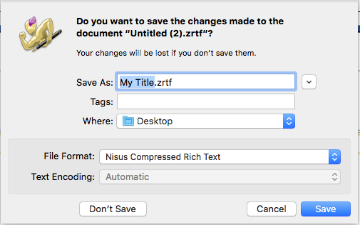

In general this is how it should work:
1. Create a new NWP document.
2. Start working in the document and some time passes.
3. Autosave kicks in, saving your document with an automatic file name (Untitled 123).
4. When you close the document, you will be prompted whether or not you want to keep the document. In that prompt you can choose a proper file name for the document, as well as its final location:
One preference that may be a factor: do you have "keep all new documents without asking me" enabled? If so, then you will not be prompted to keep, discard, or name your new documents when they are closed.
If you are seeing different behavior, please let us know what versions of NWP and OSX you are using. They are both a factor.

Thanks Martin, this sounds good. All I want is the prompt... :) I'll give it a go.
