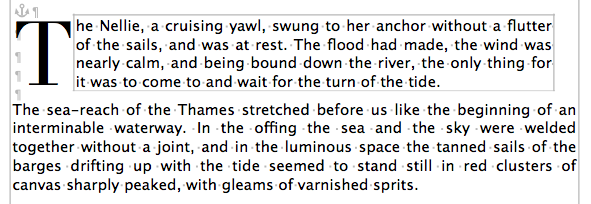

Is there a way to create initial letters with Nisus?
Enclosed a snapshot how it should look like.
Thanks for help

Have you tried text boxes?useeger wrote:I fear, the only way to accomplish that task is to insert the initials as graphics
Re: Initials
Oh, nice idea! Didn't try it. Seems to be a little bit tricky with the spacing of the lines (in your example line 4 has an additional space, what is not wanted).

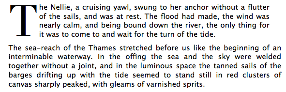

I made it now by inserting graphics of the big letters. It worked fine and it wasn't as complicated as I feared.
Enclosed an example how it looks like now
Thanks for help

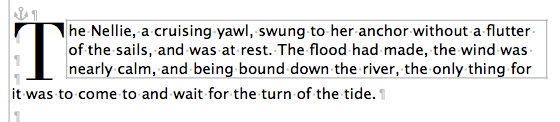

You can use the Shape Metrics palette to tweak the size and determine where the shapes appear on the page.
I think line 4 has now the same space:

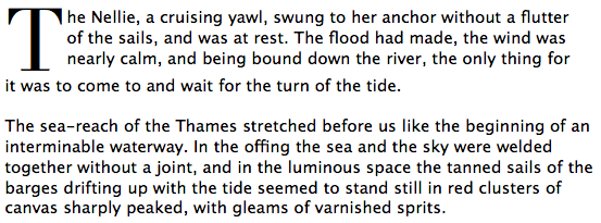

Re: Initials
Very nice, never saw before "shape metrics". One never stops learning.
But now line 5 should also have the same space, then it is perfect.
Re: Initials
This was done deliberately, because my "Lorem Ipsum" text shows the first two paragraphs of the novella Heart of Darkness by Józef Teodor Nałęcz Konrad Korzeniowski, better known as Joseph Conrad. The 5th line is the second paragraph of the story; therefore the additional space.useeger wrote:But now line 5 should also have the same space, then it is perfect.
If you give me your first 4 lines, then I can see whether this is possible. It is also important to know how big you want the "S" to be. The screenshots you provided are not very helpful. They just indicate that you want Drop Caps.

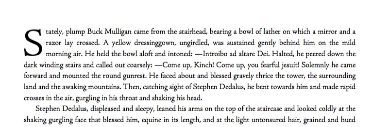

I think, there does not exist a printed edition of Joseph Conrad with additional space before paragraphs. In print a new paragraph is marked by indentation, not by additional space.
I prefer 3 lines for the height of the initials, but that's not important, others may make 4,5,6 ... lines. Enclosed an example how it should look like, I hope it's clearer now. I am sorry for my lack of clarity.
If the first paragraph of a chapter is very short (in my case less than 4 lines), these initials make some additional problems. Therefore I avoided the paragraphs which are in the original text in my example .
- Bildschirmfoto 2015-09-17 um 23.29.jpg (96.73 KiB) Viewed 47887 times

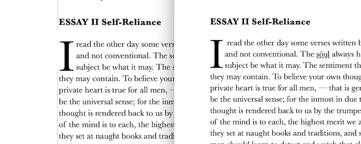

Still in learning mode with Nisus here; had to try this. Really, once you get a handle on the variables you can tweak, to do this for 20 chapters should not be onerous, especially relative to what you've invested in writing 20 chapters, I would imagine.
The attached screenshot compares a Nisus drop cap on the left, following the steps above, with the automatic drop cap using Pages on the right. I'd say the Nisus Way would be viable. I see I could have tweaked the alignment a touch. If the box is selected, you can use the cursor arrow keys to joggle it a touch, more precisely than with my MBP trackpad. From a typesetting standpoint, the ideal would be for the baseline of your dropped cap to match the baseline of line you've dropped to, and to have the top your dropped cap to align with cap line, the height of the uppercase letters of your font, of your first line.
Brad
Brad
