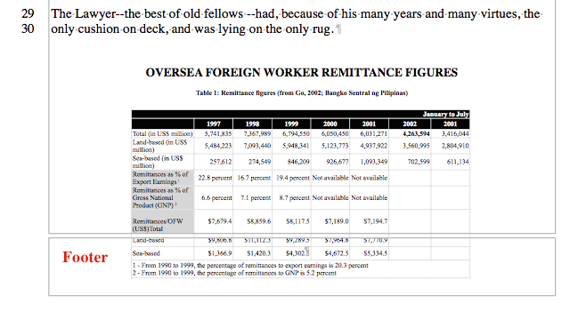

Þorvarður wrote:Have you tried to insert the table as watermark from the Tools menu ? That gives you quite a lot of options, including size scaling.
You first create the table in an empty Nisus document. Save it as PDF. Then use that PDF as a watermark, and scale it until it fits.
But surely you could achieve the same by merely using a suitably smaller font or font size for the table.
Re: Prevent table splitting?
> Have you tried to insert the table as watermark from the Tools menu ? That gives you quite a lot of options, including size scaling. […]
Mark, I think there is one decisive difference. If she has just a few rows, a watermark can be made so that it flows into the footer without splitting the rows. Thus you gain additional space. A table can't do that.
Regarding the following screenshot, the page guides will not be visible, of course, when the document is printed or saved as PDF. The table appears as one, uninterrupted object. Correct me if I'm wrong.
Table as watermark.png (85.66 KiB) Viewed 42913 times
