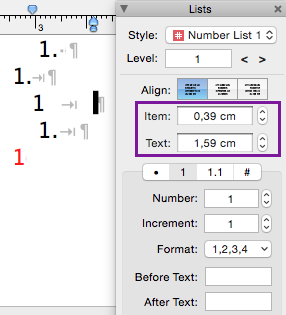

phspaelti wrote:How do you create a list with no tabs?
You are right, Philip, I shouldn't have said that. What I meant was, reducing the space which separates text from the list number so that the tab becomes (almost) invisible. The red list number shows what I mean.
Sorry about the confusion.

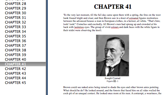

I tested my approach again today. This time it is the novel "Lord Jim" from Gutenberg with 45 chapters and 216 pages. It seems to work perfectly, as long as the problematic caption remains isolated on one line (paragraph). The image itself, however, can of course have many description lines, as long as they are separated from the problematic caption.
