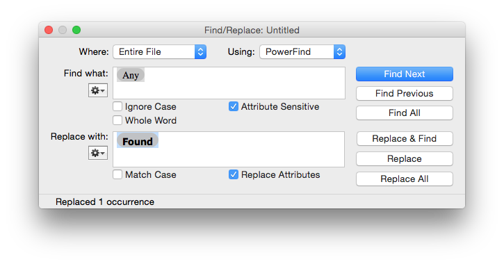

You should be able to replace with "Found" text (under the "Match" menu under the gear icon next to "Replace with:" (quoted text from the English version).
Set the style of the "Found" bullet to what you want the matched text to be styled, and it should work. I've done this sort of thing many times, and have just verified that it works with font sizes.
Screen Shot 2015-01-07 at 12.26.35 PM.png (64.44 KiB) Viewed 8297 times
