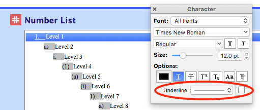

Re: List formatting
I'm sorry but this is still not possible in Nisus Writer Pro 3. List styles cannot remove formatting enforced by your paragraph styles. Your best option is likely to fake this by having your list style enforce a white underline:
That will make it appear as if the list item has no underlining in the document text:

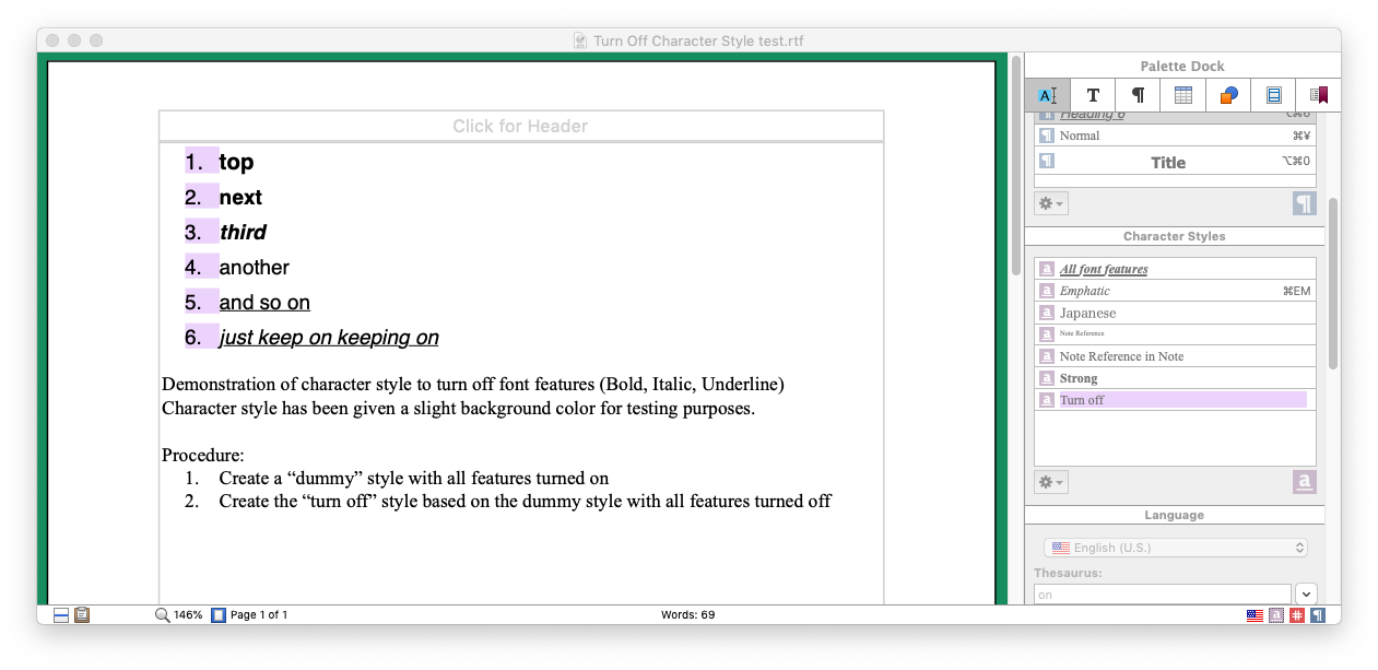

Re: List formatting
One possibility is that of using a character style to remove formatting of this kind. While the following solution is a kludge it can be made to work. While a character style cannot directly be given a feature "Unbold" or "No Underline", the trick is to first define a "dummy" character style with all the features turned on. Then create a second style based on the first with all the features turned off. This character style can then be applied to the numbers in heading paragraphs. I provide a screenshot and a demonstration file below.
Turn Off Style Demo.png (134.01 KiB) Viewed 32292 times
Turn Off Character Style test.rtf
(22.74 KiB) Downloaded 636 times
