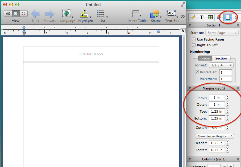

rgardner wrote:How do I create a 6 by 9 inch document, with half an inch blank space on all sides.
You'll want to adjust the paper size and margins for your document. You can adjust the paper size of your document by using the menu File > Page Setup. In there you'll see a list of standard paper sizes, as provided by the Mac system. If you don't see the size you need, you may be able to define a custom paper size. The way that works depends on your particular system version (Mac OS X).
Document margins can be adjusted in a variety of ways. The easiest is to simply click the page guides and drag-drop them to provide whatever spacing you need. If you prefer, you can also adjust the margins numerically using the Margins palette:
