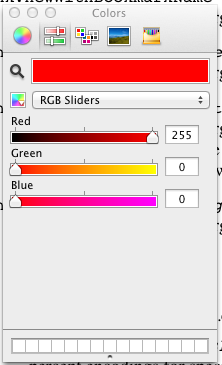

You can always switch Apple's color picker to RGB mode and inspect the value you have selected in Nisus Writer:
This works for text coloring and table cell shading. Likewise you can select any table cell in NWP and look at the state of the Table Cell Shading palette to see the blend percentage.
