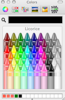

I'm working on a project that has several colors in it. If I open it in another computer, the colors I've placed in the bottom boxes won't be visible (pre-selected) since they are Apple-specific, not NWP-specific. Is there a way to find out what colors are used in a NWP file and then put those colors in the boxes in the color palette?
Also, for shading in tables, I'm using a 40% Blend of a green color for certain things. Elsewhere, I'm using a 10% Blend of black (Licorice) to get gray. I predict I'll forget what percentages I used. Is there a way to find out what I used in a certain file? As a related comment, I can use the "Dropper" to select the formatting in one cell of a table (the Dropper fills up), but I don't see how to make it apply that to another cell.
color pallette with manually added colors in boxes below.png (57.09 KiB) Viewed 6510 times

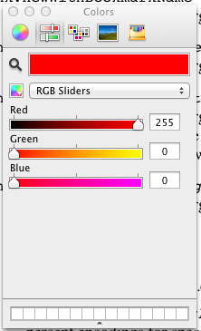

NisusUser wrote:Is there a way to find out what colors are used in a NWP file and then put those colors in the boxes in the color palette?
You can always switch Apple's color picker to RGB mode and inspect the value you have selected in Nisus Writer:
This works for text coloring and table cell shading. Likewise you can select any table cell in NWP and look at the state of the Table Cell Shading palette to see the blend percentage.
