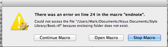

And it all works perfectly. But when I add the code for importing the stylesheet:
# Import stylesheet
$styleSheet = Document.open '~/Users/Mark/Documents/Nisus Documents/Style Library⁠/Book.rtf'
$doc.addStyles $styleSheet.text, 'replace'
$styleSheet.close
It barfs with the following error alerts:
“There was an error on line 24 in the macro “endnote”.
Could not access the file “~/users/Mark/Documents/Nisus Documents/Style Library/Book.rtf” because enclosing folder does not exist.
Attempt to set variable using a command that does not return a value.
There was an error on line 25 in the macro “endnote”.
The “text” property requires an object, instead found “undefined” from “$styleSheet"
I’ve checked the file path in the Book.rtf stylesheet and I cant see any errors in it. If I leave that code out, run the macro on the file, then import the stylesheet manually, it works perfectly.
Re: applying menu commands and importing stylesheets
xiamenese wrote:… But when I add the code for importing the stylesheet:
# Import stylesheet
$styleSheet.close
It barfs with the following error alerts: …
The second and third error are just on account of the first failure.
Actually '~' in a file path designates the "Home" folder, so I am guessing that you should be writing:
$styleSheet = Document.open '~/Documents/Nisus Documents/Style Library⁠/Book.rtf'
If that still doesn't work, you can try using an absolute path (one that starts with '/' and does not contain any '~').
xiamenese
Posts: 577
Joined: 2006-12-08 00:46:44
Post by xiamenese »
phspaelti wrote:The second and third error are just on account of the first failure.
Still doesn’t work, and I can’t find any absolute path, beginning at any point — even starting with the name of the computer with or without an initial ‘/‘ — that works.
Leave it for the moment, Philip; you’ve spent enough of your time on my little problem. I’ll email Martin and see what he says. I’ll let you know when I hear from him.

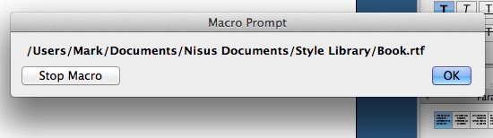

Hmm....
Here's a macro that you can run to find the correct file path. (You could also adjust it to open the correct file for you :) )
Find Style Library File 'Book'.nwm

xiamenese
Posts: 577
Post by xiamenese »
phspaelti wrote:Hmm....
Hmm … as you say! :wink:
Ran the macro, result:
Nisus Writer ProScreenSnapz005.jpg (27.09 KiB) Viewed 31276 times
Put that file path in the other macro, result:
Nisus Writer ProScreenSnapz004.jpg (34.36 KiB) Viewed 31276 times
If I change the last line to
open $styleLibFiles[$ind]
'Book.rtf' opens without problem, so I'll see if I can work out how to include that in my macro and to copy the styles across into my target document.
Thanks so much for your continuing support.
