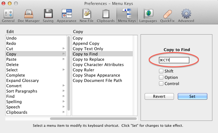

two problems with defined shortcuts:
1. I have got a shortcut CMD-CTF for "copy to find“ (zum suchen kopieren). But it doesn’t activate the menu command and I have to do it by a mouse gesture.
2. I tried to reassign that command, but only CMD-C is shown in the shorcut window with a conflict to the shortcut of Copy.
Best Matze

Matze wrote:1. I have got a shortcut CMD-CTF for "copy to find“ (zum suchen kopieren). But it doesn’t activate the menu command and I have to do it by a mouse gesture.
The first thing I'd check is if you have the "CTF" multi-key shortcut successfully set in your Menu Key preferences:
If that looks good, then perhaps the problem is how you activate the shortcut? As Mark said, you will need to hold down the Command key the entire time you press "C", "T", and finally "F", ie: the shortcut is completed/triggered when the Command key is released.
If all that is in order, I would ask: have you ever successfully triggered any multi-key shortcuts?

first: yes it has been successfully set in the prefs.
second: yes, I hold down the CMD-Key until all three CTF are pressed
third: yes, I did. For example I do use a macro (Philip's, thanks Philip ;-)) which I trigger successfully with CMD-DS.
Best, Matze
