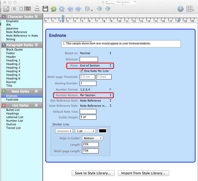

Anyhow, once your paragraph breaks have been replaced with section breaks, you can insert *Endnotes* in the usual way. Make sure to go to the style sheet to change the placement of the notes to "End of Section" (from "End of Document"). I believe you will also be able to set the notes to restart the numbering "each section".
Endnotes per section.jpg (74.69 KiB) Viewed 53503 times
Hope this helps.
