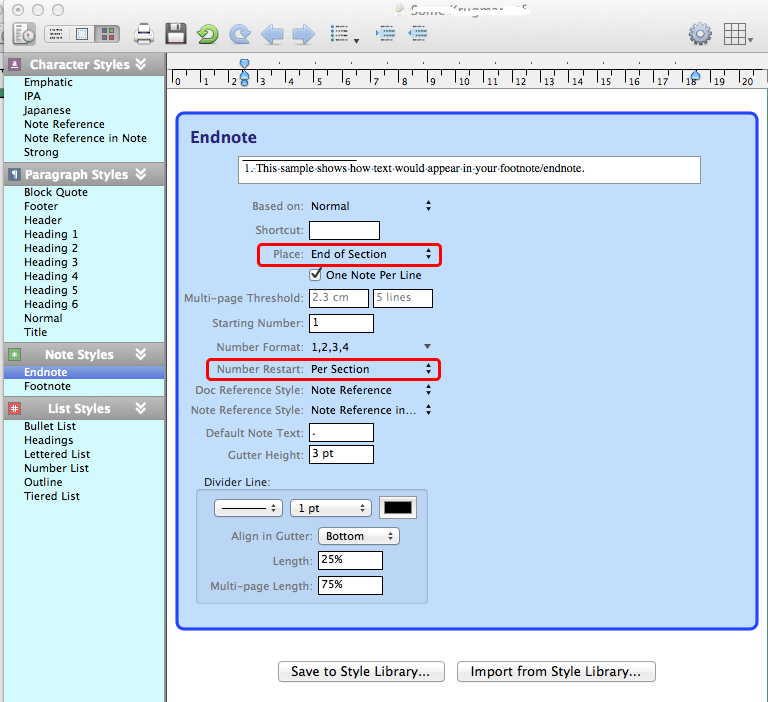

Anyhow, once your paragraph breaks have been replaced with section breaks, you can insert *Endnotes* in the usual way. Make sure to go to the style sheet to change the placement of the notes to "End of Section" (from "End of Document"). I believe you will also be able to set the notes to restart the numbering "each section".

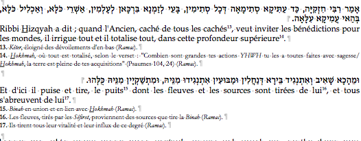

her's an example of what i do manually

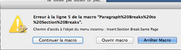

i tried the second macro and i got the following error message (in french)
error on the line 5
error on the line 5

This is because of localisation. The macro contains a Menu command which is the English name of the command. But since you are using French, you would need to replace that with the French command.msebban wrote: i tried the second macro and i got the following error message (in french)
error on the line 5

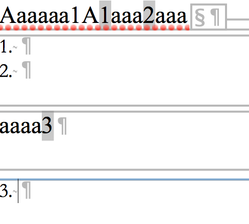

1) i fix the macro, it's fine
i made a test and it's going this way

i need now to fix the space between notes and paragraphs and insert new section to come back to a new paragraph etc…
here's a sample of the way i do it manually. all my current work is based on the same model.

Finally when the macro has finished, go to the style sheet and set the endnote settings the way you want them, as explained previously.

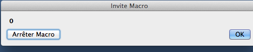

i translated the menu command as you indicated and it doesn't run
i also try the select and run selection macro it doesn't run either
