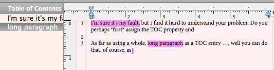

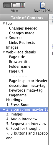

Since the Navigator/ToC panel on the left of the window is usually far too narrow to show any more than a couple of words, see attached image, my ToC entries are mostly only a few words from a heading or paragraph. I very rarely print documents or use Tools/Table of Contents/Insert TOC, I mostly use ToC entries in the Navigator panel as a superb way to navigate around a document.
If you use Navigator/ToC entries, please post to say which you use as a TOC entry more frequently:
1) an entire paragraph or
2) just several words from a heading or paragraph
Why do I ask? To gain support to reverse a rather unusual default option in NWP.
Usually when you select something, your next action applies to the selected text - but NOT with ToC entries. If you position the cursor at the end of an existing ToC entry (selecting nothing) and then go remove ToC, instead of just applying no ToC to any text you then insert, NWP by default removes ToC from the WHOLE entry.
This unusual behavior is because most users are believed to use entire paragraphs - rather than selected words in a paragraph - for most ToC entries. But are most documents actually printed nowadays? Is a full Insert ToC in the document the main use of a ToC , or are ToC entries now more often being used for intra-document navigation as in the screen-shot below?
So please post your response to show whether or not Nisus need to reconsider this unusual NWP behavior here.

- Navigator pane with ToC entries - very useful for navigating around a document.
- Navigator-ToC-entries.png (33.75 KiB) Viewed 12975 times

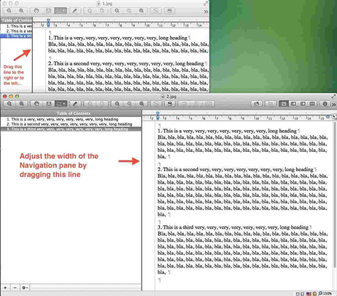

To enlarge the Navigator Pane, drag the vertical line to the right (see the 2 screen shots below).CrisB wrote:Since the Navigator/ToC panel on the left of the window is usually far too narrow to show any more than a couple of words, see attached image, my ToC entries are mostly only a few words from a heading or paragraph.
- 4 for Web.jpg (92.78 KiB) Viewed 12861 times

Thanks, Bovardur. Yes, I've known I can widen the Navigator pane for many years now. But the wider you make it, the less space you have for the content. That's why I said it's "usually" far too narrow...

You can also apply TOC to any contiguous selection only within a paragraph. To do that you have to use the Reference Tools palette:
Re: Are your ToC entries all or part of a heading/paragraph?
Yes, NWP will allow you to just mark part of a paragraph's text for TOC inclusion, so long as that part is contiguous.
The behavior that Cris dislikes is how if you do not have an explicit selection (ie: you have just an insertion point) then NWP assumes you want the whole paragraph either added or removed from the TOC. We presume that most users prefer to have entire paragraphs in the TOC, so this is designed as a convenience, which you can override using an explicit selection.
