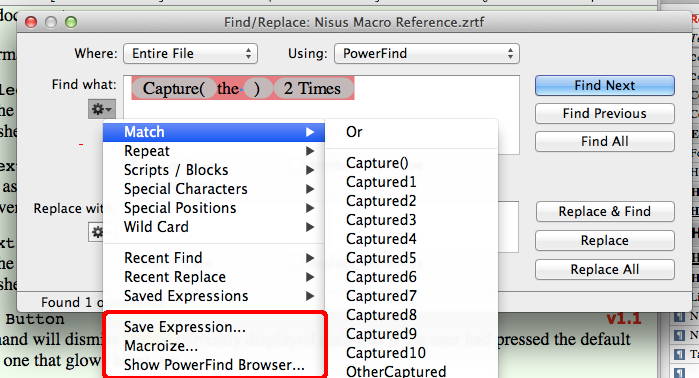

What specifically do the <0+> in your attachment do?
Also, is there any way to save entries made in the Find/Replace popup?
Howard

writerhoward wrote:Martin, Thank you for what you wrote. I was confused by the meaning of <0+>.
Sorry. I guess my explanation was a bit too short.
The real power of Nisus' Find/Replace lies in those pop-up menus to the left of the Find Box.
writerhoward wrote:What specifically do the <0+> in your attachment do?
The Repeat commands apply to the immediately preceding character. If you want them to apply to several characters at once, you need to use Match brackets.
writerhoward wrote:Also, is there any way to save entries made in the Find/Replace popup?
The pop-up has a feature to save expressions. Another option is you can use the Macroize… feature which will save the Find and the Replace as a unit command in a Nisus macro in the Macro menu.

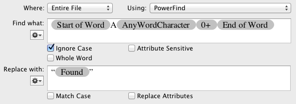

Could you provide an example that includes the (Found) bubble?
Re: PowerFind question
writerhoward wrote:Could you provide an example that includes the (Found) bubble?
Sure thing. As a contrived example let's add quotation marks around all words that start with the letter "A":
