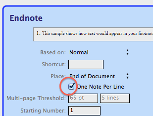

Re: Endnotes as 2-column while still automatic?
Have your tried getting more than one endnote per line?
You can get multiple short notes on the same line by unchecking the 'One Note Per Line' box in Style Sheet:
Multiple Endnotes per line.gif (14.53 KiB) Viewed 11524 times

Hamid wrote:Have your tried getting more than one endnote per line?
Hamid thanks for the reminder; it may work as a cludge workaround. I had tried that long ago and I needed columns so I thought it wasn't useful, but I just tried again and realized I could put tab stops and with a little judicious careful work on certain lines I could get columns.
They read across instead of down, which is not ideal, but it may be better than a single column over 3 pages. They will also need to be reformatted whenever I need the references re-numbered, so it will only be useful at the end when all else is done; but they may at least allow continuing to use .rtf instead of needing to make the final in PDF and swapping pages.
