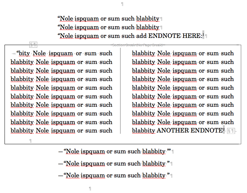

Martin, I feel I'm building up to a substantial (and possibly valid) complaint about an obvious feature that you do not yet have the capability of handling in Nisus. I hope I'm wrong.martin wrote:Ah, my apologies Steven! I didn't notice you were talking about a regular block of text in the document body, not a floating text box. I should have read more carefully.
Well, that being the situation, there's no way to have the shape not respond to clicks first, even if the shape draws behind regular body text. Depending on your situation, and what you're doing with these squares, I might suggest that you use the paragraph borders/shading feature. That would allow you to add a border to a paragraph that won't interfere with regular text editing. Other possibilities: section watermarks, table cells, or floating text boxes.
What I'm attempting is a half-page of two-column text, with full capabilities for footnote/endnotes from the text, surrounded by a simple square box.
This sort of arrangement is common in scientific publishing; peer-reviewed papers often have one-column at the top of a new paper and two columns thereafter; sometimes the reverse. Often one of the forms has a box around it. Mine is a variant on this.
I've tried tables and boxes; they don't support endnotes and footnotes.
I"ve tried paragraph shading/edging boxes; the overall boxes don't extend across the columns (it's 2-column, remember).
I don't see how watermarking will help, since the 2-column text needs to be in the flow of the document; and besides, given your watermarking interface/dialogs it will be hellish to try to edit and position the watermark when the text is flowing and I'm editing the text to change its sizes and styles.
So it seems to me that you need a new capability in your interface: let me click on what I can see. I can see the text. I can see the box around the text. But you don't let me click on the text or edit it; the graphic reigns supreme.
I suggest you institute something like done in most graphics programs: allow me to lock individual graphics. This is how this problem is usually handled. Then when the graphic is locked I can edit what it used to obscure.
If you like, I can send a screen-shot of the setup; but it's really very simple: 2 columns of text in the middle of the page, surrounded by a box; text has endnotes and footnotes. 1 column before and after that box.

I think I understand what you're after Steven, but perhaps it's best if you posted (or sent/emailed) a screenshot of what you hope to achieve. That way I won't keep suggesting options that don't serve your needs very well.

Both JPEG and PNG graphics are accepted. I've attached the file Steven sent to us directly via the feedback reporter.

As to the matter of the square shape itself, I unfortunately don't have any great solutions. I was thinking a page border might work, but now that I see you have multiple sections per page, that feature won't do.
Probably the best suggestion I can offer at this time is to use four straight lines, which you can group to make a square. The grouped lines will behave as you want, where clicks in the middle (transparent) area will fall through to the text below.
Sorry for the hassle. I think it would be best if, as you describe, clicks in the middle of a transparent square shape fall through to the text below, and only visible portions of the shape respond to clicks. Perhaps some kind of shape locking feature is also desirable. I'll file some enhancement requests- thanks!

Thanks; right, I'll build a box if necessary. That will make flow and content resizing more difficult though, and I look forward to you having locking and/or transparent shapes in future.martin wrote: Probably the best suggestion I can offer at this time is to use four straight lines, which you can group to make a square. The grouped lines will behave as you want, where clicks in the middle (transparent) area will fall through to the text below.
... I think it would be best if, as you describe, clicks in the middle of a transparent square shape fall through to the text below, and only visible portions of the shape respond to clicks. Perhaps some kind of shape locking feature is also desirable. I'll file some enhancement requests- thanks!
