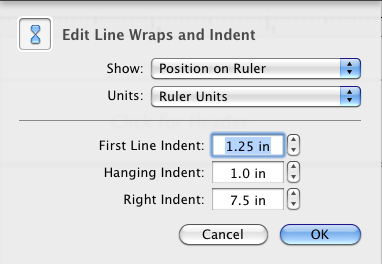

In any case, if you want to adjust the paragraph indents, you can use the little blue "gumdrop" indent markers on the ruler:
You can drag-drop any of those blue markers to adjust the indents by hand, or you can double-click a marker to bring up a sheet that allows you to adjust the indents numerically:

It sounds like the first line of every paragraph should have its indent set to 0.2" (or perhaps have an additional 0.2" of indenting). You can achieve this using the "first line indent", which you can set in Nisus Writer using any one of the following:
1. The little blue indent marker on the ruler. The first line indent marker is the one pointing downward.
2. The "first line indent" field in the indent editor sheet (which you can access by double-clicking any blue ruler indent marker).
3. The "first line" field in the Paragraph palette, under the "Indents" tab.
