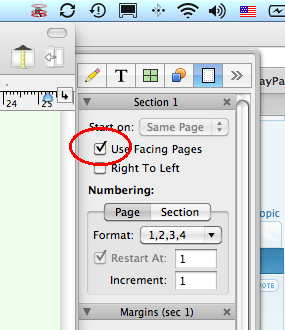

You need to set your document/section to using "Facing Pages". This can be set in the section palette. You will then have independant odd/even headers and footers. The parts that you want to be the same will have to be copied.
- Nisus Section Drawer.jpg (25.7 KiB) Viewed 7226 times

Philip's answer is exactly right: to have different headers on odd/even pages, you'll want to turn on the "facing pages" option for your section(s).

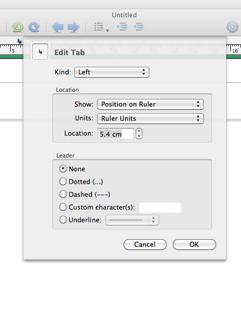

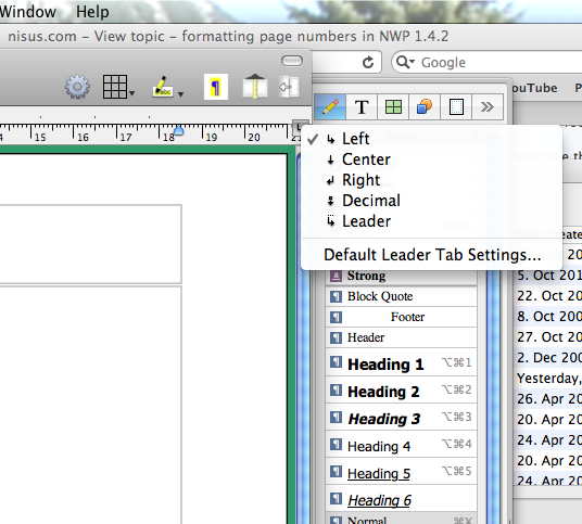

Re: formatting page numbers in NWP 1.4.2
The menu is on the right end of the ruler.
You can also double-click on a tab in the ruler to change the settings of the tab.

Thanks for the screenshots Philip. There are actually a couple ways to add a new tab stop to the ruler:
1. The menu Format > Paragraph Indents > Add Tab Stop... brings up a sheet giving you all the options available for a new tab.
2. Click once anywhere on the ruler and a tab stop will be created at that location. The type of tab stop created depends on what type is set in the "well" on the right side of the ruler (see the first screenshot Philip posted).
Once you've created a tab stop you can drag it around to change its location, or double-click it to bring up the editing sheet (see Philip's second screenshot). I hope this helps.
