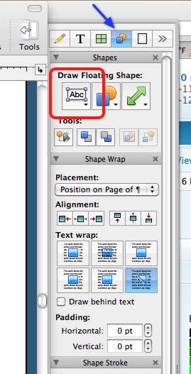

I, too, am a newbie but I've figured this one out. Actually there is a lot of information in the manual, starting on page 165 through 185. Even though Nisus calls them Text boxes, they are more generically referred to as shapes. In the later parts of the section there is information on text wrapping. Exegett77 included a screen capture of where the Text Box is on the menu bar. You also use the Shapes Palette to configure how you want the text box to appear, text wrapping, borders, fills, etc. See below.
Shapes Palatte.jpg (60.43 KiB) Viewed 32742 times
And I don't know if you can "dial in" a specific shape size, such as 1 x 1. You may have to eye-ball it.
Also, I haven't found a way to "copy and paste" a shape if you want to standardize the shape of a particular text box. And one of the cool things you can do with Nisus is copy the attributes of the text box, making it easier if you want to insert several text boxes in your document and have them all look the same.

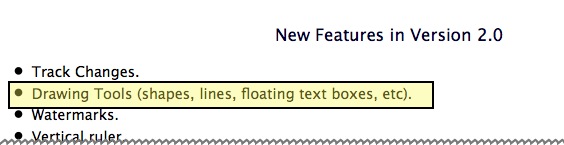

Well shiver me timbers. A quick look at the what's new in version 2.0 shows the following:
New in 2.0.jpg (28.65 KiB) Viewed 32719 times
I bet this explains why you can't find anything about Text Boxes :D

JLSchweitzer wrote:And I don't know if you can "dial in" a specific shape size, such as 1 x 1. You may have to eye-ball it.
You can set the exact size and position of a text box (or other shape) using the "Shape Metrics" palette.
This is definitely possible. Just click once to select the text box, use the menu Copy (or the venerable keyboard shortcut Command + "C"), and then paste. If you want to anchor the pasted shape elsewhere, you can also select a different bit of document text before pasting.
I wonder, maybe the problem is that you click twice to enter the text box? That would put you in text editing mode, which won't let you copy the text box wholesale. Let me know if you continue to have troubles; we'd like to have this working for you.

I can't seem to figure out how to use the quote feature on this forum to make this reply a little easier to follow. Anyway, the "Shape Metric" palette is at the bottom of the toolbar that I don't normally see it. Initially I was puzzled because I couldn't figure out how to rotate a text box but I stumbled upon Shape Metrics. So after another three weeks, it might have dawned on me that you also use the Shape Metrics to "dial in" specific or exact sizes.
With the copying and pasting, this is simply a case of w-a-y over-thinking how to do this. What I was doing to try and copy and paste was to click on a text box AND THEN RIGHT CLICK; as you know this gives you the option to copy (or paste) the shape appearance which is different from simply "copy and paste."
