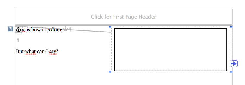

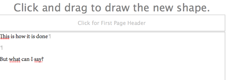

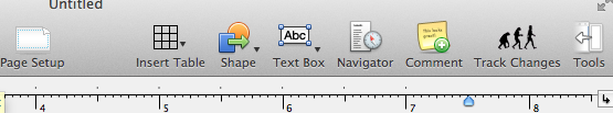

On the Toolbar next to the Navigator button (see NWP001).
Click that button: It will tell you to draw the text box anywhere (NWP002)
Completed (NWP003), note that it is anchored to whatever paragraph was selected (far left side).

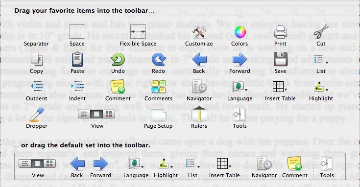

Thank you, both Exegete77 and JLSchweitzer. That's helpful. My first thought way, "Well, that explains it – I need to customize my toolbar!" However, when I went to try to do that (right click in toolbar), I got what you see in the attached file: no text box icon. That makes me think that since I'm using 1.4.2 maybe something is different than with 2.0. Maybe someone can explain how to insert a text box in 1.4.2?
BTW, I searched the 1.4.2 manual for "text box" and "shapes". For the former, so much comes up that seems totally about something else, that I found nothing. (Seems in Nisusland "text box" must mean a dialog box in which you enter text?) For the latter ("shape" or "shapes"), I also found nothing helpful.

Oops. I forgot to attach the screenshot.

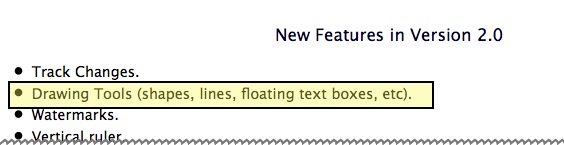

Well shiver me timbers. A quick look at the what's new in version 2.0 shows the following:
I bet this explains why you can't find anything about Text Boxes
