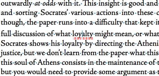

I noticed that when I add some of the special character spaces such as thin space, hair space, non-breaking zero width space (but NOT the non-breaking space), the height of the line with that special character space visually increases by what look a point or two (although the actual line height number in the paragraph palette does not show any change).
I first noticed this with Adobe type faces, but have tried it with Apple ones too, and noticed the same thing.

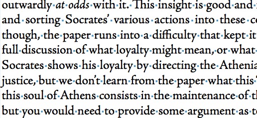

Just to illustrate, I've attached two screen shots: the bottom one with no special character spaces; the top one with a non-breaking zero space inserted within the word 'loyalty' (with the red underline). You can see the difference in line height that the special character space introduces.
Any work-arounds would be appreciated!

I would guess that your "non-breaking zero space" is NOT part of ANY font - how to display a "zero space" anyway? This "zero space" is handled by the text engine concerned only - with different results for different text engines.
You should not use the standard "Multiple Line Spacing" - go "Fixed Line Spacing" for all your documents instead. That does the trick…

The problem here, as Elbrecht implied, is indeed font substitution. Whatever font you're using (eg: Times), likely technically doesn't contain the zero-width space, so the text system substitutes another font. That substituted font (perhaps Lucida Grande) has a larger natural line height, so your line height is expanded. This is a bit of an annoyance, because one doesn't really care about the height of any space, but it's the way the Apple text engine works. Maybe there's something we can do to augment this process; I'll file it as something to investigate.
