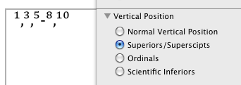

Thanks for your kind words on Nisus Writer. I'm sorry you've had trouble with the superscripts. I think I understand your problem, but to make sure, consider the following screenshot:
Is the problem that sometimes the super/sub-scripted numbers look like line one, and other times that they look like line 2? If so, I can explain the issue. In that first line proper typographic superscripts are used (ie: NWP displays special superscripted glyphs provided by your font), in the second line NWP is showing faux superscripts (accomplished by shrinking the font size and raising the baseline). Proper typographic superscripts will always look nicer and provide more clarity (and in this case are noticeably larger), because they were specially designed by the creator of the font.
Can you spot what characters are missing from the top line? The commas and dashes. When those characters are encountered they prevent the display of proper typographic superscripts because your font (Cambria) does not have glyphs for them. You can verify this in TextEdit, which does not provide faux superscripts:
When NWP encounters this situation (ie: a sequence of mixed characters, some which support proper typographic superscripts, and some which do not), NWP chooses to use faux superscripts. That's because the baselines for faux and typographic superscripts can be quite different and appear "ragged". That said, perhaps we can improve on the situation, either by special casing commas, periods, and dashes, or perhaps by allowing the mixed superscripts if the glyphs appear similar enough. We'll have to file it and investigate possible satisfactory solutions.
In the meantime, there is a way to workaround the issue, though it's not very elegant. You basically need to use different fonts/formatting for the superscripted numbers versus the commas/dashes. Any formatting difference will do; just something to give NWP the hint that it's okay if the bits of text appear slightly different. Here's a macro that will process your document so the font size of the commas/dashes in the superscripts is adjusted to 12.1 pts, leaving the numerals themselves at 12 pts:
