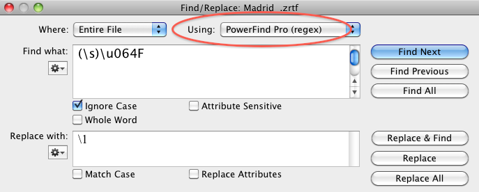

Re: HELP! Nisus document disappears
I've received your document again, thank you. It looks like you didn't delete the bad character sequence after all. Rather than have you click around and possibly miss it again, let's just have you use PowerFind Pro to eliminate the bad sequence. Here's what to do:
1. Quit Nisus Writer Pro (NWP) if it is running.
2. Relaunch NWP.
3. Open your document (but don't do any typing).
4. Open the Find & Replace window.
5. Set the "Using" mode to "PowerFind Pro":
6. As in that screenshot above, in the "Find what" field type "(\s)\u064F" (without the quotation marks).
7. As in that screenshot above, in the "Replace with" field type "\1".
8. Click the "Replace All" button.
At this point NWP should replace 2 matches. Save the corrected file. Now you should have no further troubles/crashes in this file. You might want to reset the Find & Replace window "Using" back to Normal Find.
