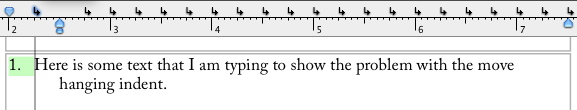

Hi Josh- this is actually a feature. The idea is that in most lists you want a nice consistent (left) edge for your text, both for the first line and any wrapped text. Visually, you can see this edge at the 2.5 inch mark in this screenshot:
To that end, the hanging indent is used as the position for text following a list item/bullet. Thus when you increase the hanging indent, the first line moves inward as well.

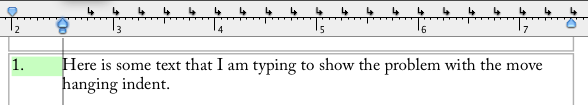

If you want to override this behavior, you can add a ruler tab stop between the two indent markers. For example, here's what happens if you insert a tab at 2.25 inches:
I hope that makes some sense.
