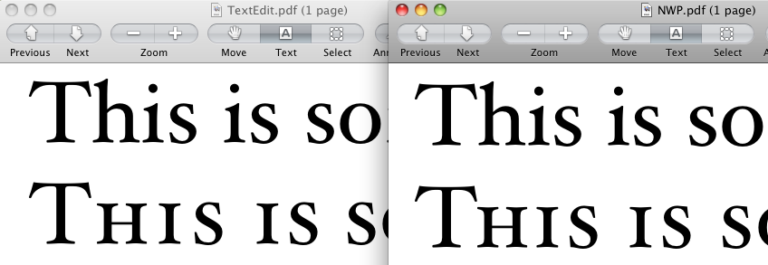

Thanks for testing that. I gave it a try myself, and the printouts from TextEdit and NWP don't seem any different to me. Of course, your printer might affect things, or your eyes might be better than mine.
Another question: do you see any difference in the PDFs that TextEdit and NWP generate? That's an easier thing to compare. I'll attach a screenshot here (TextEdit on the left, NWP on the right). They seem identical to me.

Thank you for your reply. The individual differences are subtle but do add up when the work is printed out and taken as a whole
Take for instance the spacing on the Print to PDF sample you posted.
Measure with a ruler the distance between the 'H' in 'This' (second line Caps) to the 'I' in 'In' (second line caps).
You will find that the distance is 'less' in the NWP sample compared to the Text Edit sample. by about 1.5mm. Not a lot, but this is just a small piece of text. When taken across the whole printed page the eyes view the typeface differently.
I can see this with the naked eye too. The 'THIS IS' in your TextEdit sample is clearly spaced more generously than the 'THIS IS' in the NWP sample. I wonder why this is when they are both based on the same engine.
