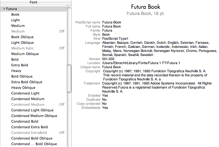

what brand of Futura Light are you using? There are lots of Futura versions out now!
Mine is still an old PostScript Type1 from Fundicion Tipografica Neufville S. A. 1997…

Elbrecht -
Mine is a PostScript Type 1, too, except that it's from 1987, not 1997. Maybe that's the point.

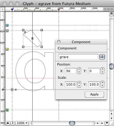

As far as I have observed, the OS X 10.6.7 bug affects glyphs which are not defined directly. There are two ways to define glyphs indirectly: [1] composite glyphs, e.g. “à” as a composite of “a” and “`” with positions and X/Y scaling (I’m speaking of the internal strucuture of fonts, which has nothing to do with the Unicode normalization) and [2] OpenType features, e.g. small caps “A” supplied by “smcp” feature, ligatured “fi” supplied by “liga” feature, etc., etc. Both the two methods are broken in some fonts and I don’t know the reasons why the other fonts (seem to) continue to work normally. That said…
ninjagame wrote:It didn't affect PDF at all. It was extremely specific: It affected only the dots in punctuation marks (periods, semicolons, the dots - and only the dots - in exclamation marks and question marks).
Presumably, those characters in your font are composite glyphs whose dots are supplied by a single base glyph and it is the relationship between the base glyph and those punctuation marks that is broken. Although not 100% sure, I tend to think that the bug does affect your PDFs but you don’t notice it because, when unable to extract embedded fonts, Adobe Reader (and Preview) tries to use glyphs from special Multiple Master fonts, very often successfully as far as MacRoman characters are concerned and it would not be very easy to distinguish, for example, Helvetica’s full stop from that of Arial.
As I don’t have the time to downgrade to an earlier version of OS X and the only affected font indispensable for me is a custom font for Arabic transliteration, I just generated a TrueType version of it using FontLab Studio, which seems to work fine. That workaround would be worth trying for those who are in a similar situation and familiar with a font editor.
Edit: tried to make my posting clearer.

I guess you know, but there is always a possible font conflict with the OS X version of Futura - that's why I disable the OS X version in Font Book to enjoy my old Type 1 Futura. And you are right somehow with 1987 - way back in the very beginning…
http://www.elbrecht.com/PNGs/Futura.png
HE

Groucho wrote:Though I don’t know why a foundry should rely on a composite for an exclamation mark, or question mark, to name a few. I do have Futura, two versions, both of them True Type. […] They don’t allow of any composite version of question marks or any other marks, as far as I see.
No, no, what I mean by “composite glyphs” has nothing to do with Unicode’s precomposed/decomposed characters or some OpenType/AAT features and is invisible to end users. The composition in “composite glyphs” is an easy way to create glyphs which are similar in a certain sense, to keep the consistency (shape, scale, relative position) among them, and to make the font file size smaller. Perhaps you can compare it to NWP’s character/paragraph styles. You could get the same print out whether you apply style attributes via styles or manually and individually. However, the use of styles makes it much easier to change a style attribute globally and consistently.
AFAIK, the composition is used usually for accented letters as you see above and not for punctuation marks but this might be effective (I’m just guessing; I don’t have Futura Light) when you need to create a family of typefaces of various weights, e.g. regular, light, ultra light, thin, bold, black, extra black, etc.
