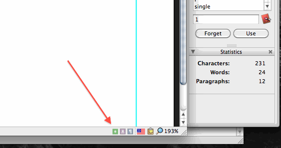

Try typing some text and adding a note anywhere (Insert > Footnote or Insert > Endnote). Footnote and Endnote styles only appear after you have created a footnote/endnote. Anyway, you won’t see them in the Style palette. After you have created the first note, a new green tag appears on the statusbar. See below:

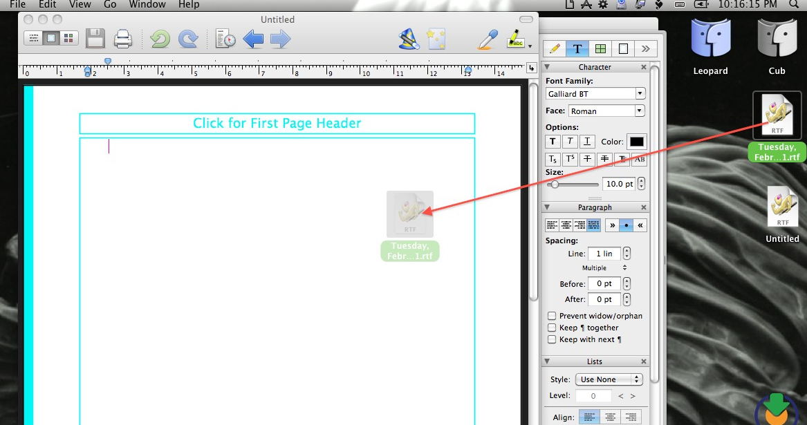

Now for the icon.
Select a file in Scrivener and export it into a folder (File > Export > Files…). Choose Rich Text from the Export main text as drop-down.
Create a new file in NWP and set margins, styles and everything the way you deem best. To speed up things, you can duplicate an existing document you think is alright, select all and delete all. Even better, you can save this document as a template, with .dot extension, that you can use as many times as you like.
Open the folder with the exported file. Select the file (the file’s icon) and drag it into the open document, right on the page.
Screenshot 2011-02-08.jpg (98.08 KiB) Viewed 16606 times
NWP might ask what to do in case of conflicting styles. Click on Use Existing Styles. That’s it.
Greetings, Henry.
